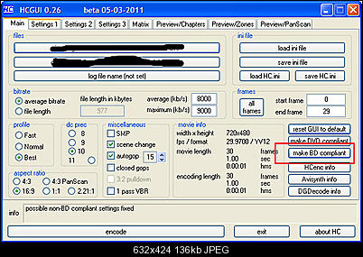

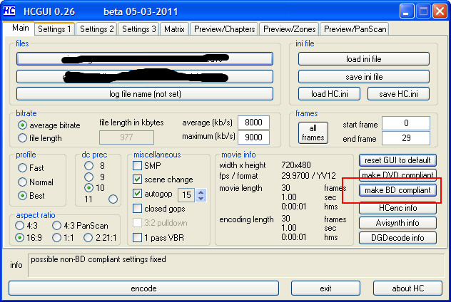

  5. OK thanks. It's just that I was getting worried when in HC Encoder there was a "make BD compliant" button which when pressed changed the bitrate to 9,800 Mbps (the DVD maximum).

  9. Originally Posted by jman98 View Post
    I think your memory is faulty, but if you can back up what you say, I'd love to see it and be proven right. HCenc has a button that says "make DVD compliant" which would indeed limit your bitrate, but there is no such button for BD compliance. And I can find no evidence of any H.264 version of HCenc.
    The beta has the button. I don't know how well it works for BD encoding, and I've never heard of h264 version either
    Actually, he's changed the beta since I last got it. I also use that very version of the beta, but my copy (about 1 year old) does not have the BD compliance button. Interesting. Thanks for pointing that out.
