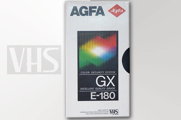

  10. Originally Posted by megasaja View Post
    AGFA GX E-240 VHS Pal Secam Made in Germany
    [Attachment 11015 - Click to enlarge]
    like this only 240 minutes..
    €dit: I wanted to store on dvd
    This is problematic. NTSC at SP (120mins) or PAL at SP (180mins) will digitize decently to either a 4.2GB data file (H.264 etc) or 4.2GB MPEG2 standard DVD. The 180min PAL tape is pushing the limit of acceptable digital quality if you insist on fitting the full 180mins onto a single DVD, its usually better to split the tape into two parts using two DVDs. Unless there are lots of advertisements that you can edit out before making the final file: many of us do this. You figure out the running time of the adverts and delete that from your calculation of video bitrate setting. In America, we average 14mins of adverts per hour, or 45mins total for 3 hours. Cutting these adverts would reduce the actual capture to 135 mins, allowing a higher bitrate and much better quality video file than squeezing the full 180mins onto a DVD. The trick here is to adjust your video encoder to a setting optimal for 135 mins, then digitize the entire T180 (resulting in a huge file that could not fit on one DVD). When finished, use your editing software to delete the adverts, and you will be left with a final file that will fit on one DVD. If there are no or few adverts on your tapes, you'll probably need to split the material somehow to not code more than 125 mins into 4.2GB (if the T180 holds multiple half-hour or hour-long shows, split the shows into smaller groups).
    Edit2: i would call anyone misguided who accepted a ratio of worse than 1dvd/1cassette while digitizing 300 tapes, or just desensitized to producing mountains of electro junk down the road
    Don't misunderstand me: I did not call you yourself misguided, I meant only that its a common misconception among all newcomers to digital VHS transfer (that it is a simple 1>1 process, that 1 tape no matter the running time, will fit on 1 dvd). The misconception is natural, it should work that way, unfortunately it doesn't quite because digital video is rather inhospitable to encoding analog VHS. Analog VHS is full of instabilities, distortion and noise that is invisible to our own eyes when watching the tape but VERY "visible" to a digital encoder: the invisible part of the VHS signal sucks up bandwidth at twice the rate necessary to digitize a good DVB-T broadcast. So the "logical" idea of fitting a single T180 cassette with 240 mins of material into a file size that would fit a single DVD is inadvisable.
    Not to say you can't do it: of course you can, many people do- they just don't notice or care that it looks pretty bad, or they give no thought that ten years from now TV displays will change again (as will the manner we store digital files), and those borderline-acceptable 240-min-per-dvd files will be less adaptable than 125-mins-per-dvd. Either way, there is a baseline maximum quality you can achieve at a given file size. A 4.2GB AVI H.264 made from an old 240min VHS is not going to look anywhere near as good as a 240min 4.2GB file you download from the web, that was encoded from commercial DVD, BluRay or current broadcast.
