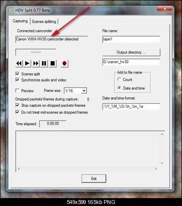

    here's a screenshot of an HDV with hdvsplit. all that's required is the cam on play and plugged in to the firewire port and this shows up. nothing else was ever installed.
    maybe re-install your firewire chipset driver. or buy an add-in firewire card.

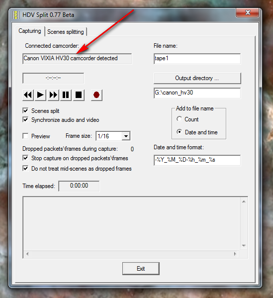

    [Attachment 10911 - Click to enlarge]

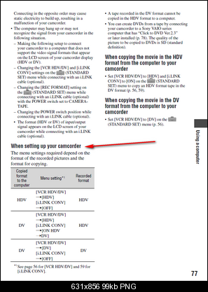

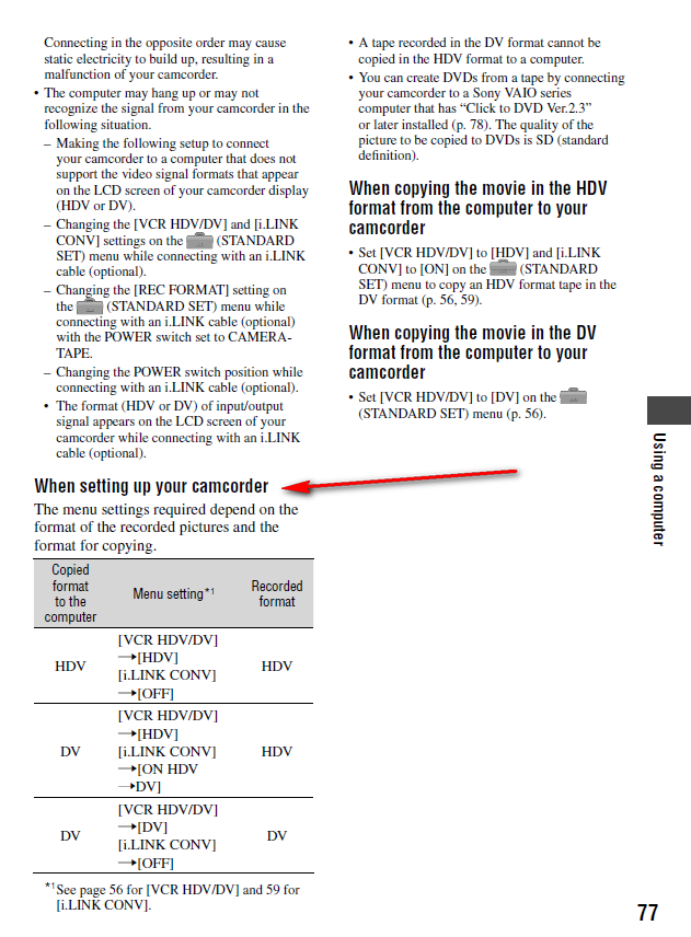

    from the manual

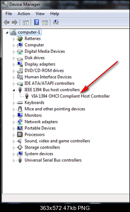

    check your computer hardware listing to make sure the firewire port is installed and working. right click "my computer" select properties, click on device manager. see how your ieee1394 port is listed.

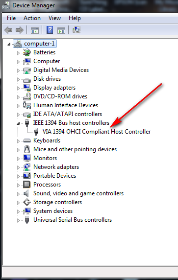

    [Attachment 10920 - Click to enlarge]
    I am trying WinDV and it is not recognizing my camera. When I turn camera on the WinDV does nothing.
    Yes, the firewire port looks correct
