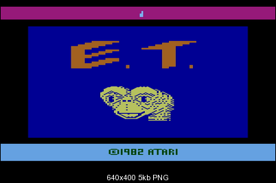

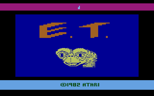

  8. Stella, recorded with VirtualDub (screen cap), filtered (resized) in AviSynth:
    It could probably use some aspect ratio adjustment. I realize not all games will run properly in Stella.
