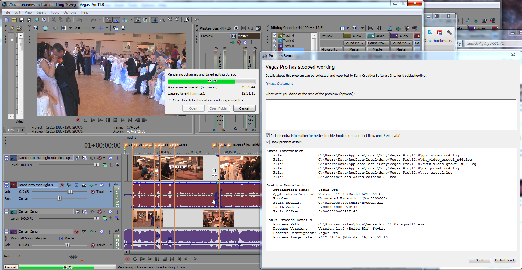

    During a render, I can watch a few frames occasionally flash purple, and then at about 1% done it does fails regardless of whether the source video is adjusted to match output... I can;t find any graphics accelleration function to turn off or other fix:
    Extra Information
    File: C:\Users\Kava\AppData\Local\Sony\Vegas Pro\11.0\gpu_video_x64.log
    File: C:\Users\Kava\AppData\Local\Sony\Vegas Pro\11.0\dx_video_grovel_x64.log
    File: C:\Users\Kava\AppData\Local\Sony\Vegas Pro\11.0\svfx_video_grovel_x64.log
    File: C:\Users\Kava\AppData\Local\Sony\Vegas Pro\11.0\dx_grovel_x64.log
    File: C:\Users\Kava\AppData\Local\Sony\Vegas Pro\11.0\vst_grovel.log
    File: F:\Johannes + Jared\Jared and Johannes\Johannes and Jared editing 27 Done Editing.veg
    Problem Description
    Application Name: Vegas Pro
    Application Version: Version 11.0 (Build 521) 64-bit
    Problem: Unmanaged Exception (0xc0000005)
    Fault Module: C:\Windows\system32\nvcuda.dll
    Fault Address: 0x000000000694E140
    Fault Offset: 0x000000000027E140
    Fault Process Details
    Process Path: C:\Program Files\Sony\Vegas Pro 11.0\vegas110.exe
    Process Version: Version 11.0 (Build 521) 64-bit
    Process Description: Vegas Pro
    Process Image Date: 2012-01-16 (Mon Jan 16) 23:51:16
    Nov 2011

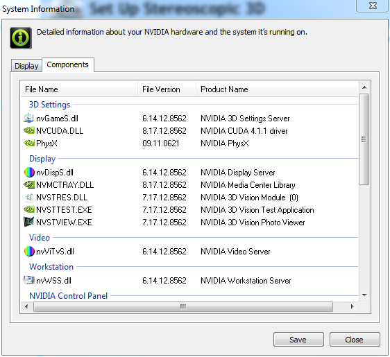

    Graphics card is
    About Your GPU
    GeForce GT 240
    Your GPU Supports
    3D Vision
    PhysX CUDA
    Your GPU does not support
    Info >DirectX 11
    Info >SLI
    Your core specs
    Cores
    96
    Memory
    1024MB
    Graphics clock
    550MHz
    Nov 2011
    Just re-installed Driver version 285.62 "clean install" to reset all settings.

  5. aBigMeanie aedipuss's Avatar
    Oct 2005
    666th portal
    when you render set vegas to only use the cpu. your video card is the problem, might be overheating or has bad ram.
