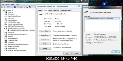

  5. Do the firewire ports show up in Device Manager?
    When you plug the camera in (or switch the camera on) does Windows make the connect sound?

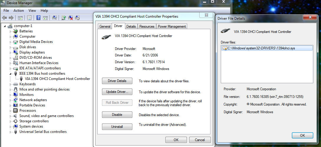

    check your via firewire port driver, it should be listed like this.

    If the mobo has a VIA chipset, like the one shown below, the VIA 4-in-one driver installs the IEEE-1394 driver and it shows like this. You need to install your mobo drivers.
    All my PCI card IEEE-1394 cards have TI chipsets. Windows seems to see those.
