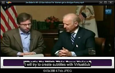

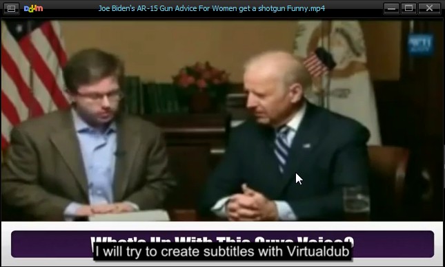

    If the ASS file is correct (timing, etc.) and you just wish to add the black background, you can just edit the ASS file directly with notepad (or a Mac word processor)and change the Borderstyle to 3:
    [Script Info]
    [V4 Styles]
    Format: Name, Fontname, Fontsize, PrimaryColour, SecondaryColour, TertiaryColour, BackColour, Bold, Italic, BorderStyle, Outline, Shadow, Alignment, MarginL, MarginR, MarginV, AlphaLevel, Encoding
    Style: Default,Arial,20,16777215,255,0,0,0,0,3,2,2,2,10,10,10,0,1
    That should produce the desired effect as shown below:
