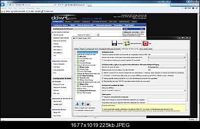

    Originally Posted by sdvideohelp View Post
    can't do that, I'm restricted to whatever can run on dd-wrt.
    Whats problem?? I´m dd-wrt user too...PS3 Media Server Work flawless.
