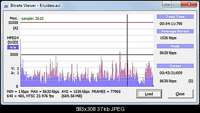

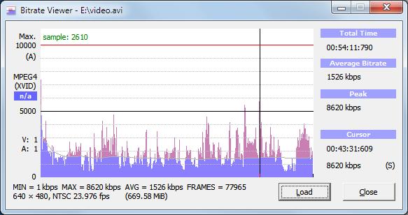

    Use Bitrate Viewer to see if bitrate peaks coincide with the problem points. For example, the following video has a bitrate peak of 8620 kbps at 43 minutes and 31 seconds into the video:
