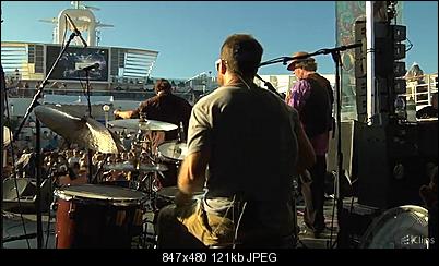

  1. I have some video clips I downloaded that all look similar in MediaInfo as pasted below. Despite the low bit rate, the quality is not as bad as you may think -- see screen shot below the MediaInfo data. My question is about what bit rate I should use to avoid losing video quality when converting these files to MPEG2 format for eventual burn to DVD? I find it hard to believe that I could get away with using 2000 kbps and not lose quality, but then again I could be wrong. Opinions?
