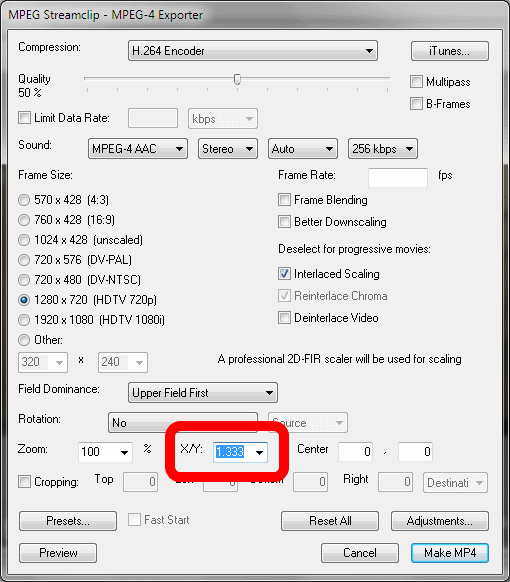

    Try resize the video to 1280x720 in mpeg streamclip and you should get black borders (see http://www.foolishpassion.org/vidding-tips/fixing-squished.html for some tips).

    Try change the X/Y: to 1.333 in mpeg streamclip. Hit Preview and see how it looks like.
    edit: I just tried mpegstreamclip with a 1024x428pixels(2.40:1) source resized to 1280x720p with the X/Y: 1.33 and it looks fine with black borders.
