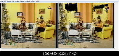

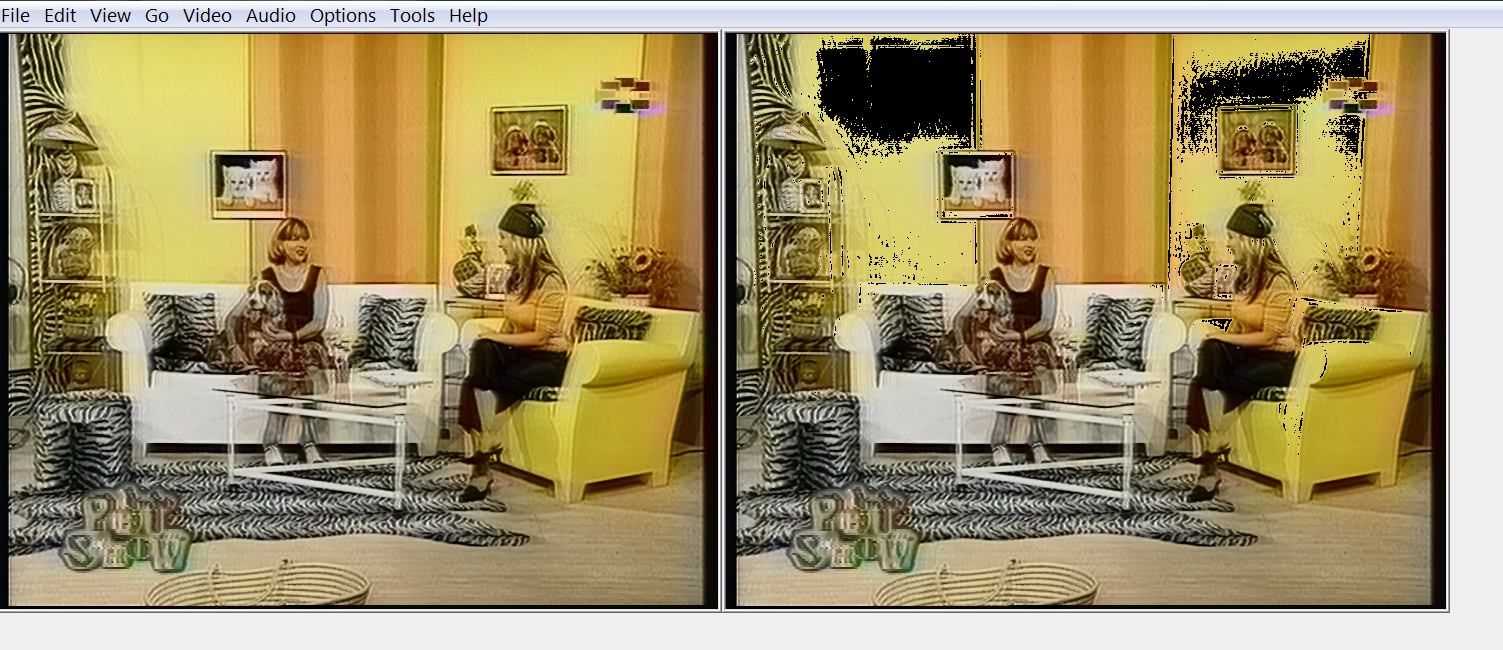

    I tested the video with color tools (autor description "Main use is a vectorscope and waveform monitor. It also checks for 'hot' colors and does histograms") and there are hot colors ( whatever that means) sanlyn?

    ColorTools marks colors as "hot' if they are outside the dislpay range you request for his histogram and vectorscope (usually RGB 16-235). But chroma can go to RGB 240 legally, and PAL goes higher (you have to specify that in ColorTools setup options). Since the designer is even more picky than his users, I wouldn't even use the hot colors option. Colors are also considered hot if they're severely oversaturated and dominate the image
    The histogram, scopes, and your eyes should tell you if you're crushing or blowing out colors and detail. The ColorTools vectorscope is similar to those in high end software (Premiere Pro, AfterEffects, etc.). This is a vectorscope of that scene from video2.avi before corrections (left) and after (right).
    [Attachment 11403 - Click to enlarge]
    You can see on the left that yellow (which is red +green) dominates. Yellow's opposite color (blue) is so weak it barely appears in the scope. On many vectorscopes you'll also see the small squares in the center of each segment. Colors that extend beyond the inner range of small squares indicate overbrightness, particularly in terms of what is considered suitable for tv viewing.
    Using various scopes is covered on a VirtualDub post-processing page at doom9, about 1/2 way down the length of the page at this link: http://www.doom9.org/index.html?/capture/postprocessing_vdub.html .
