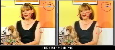

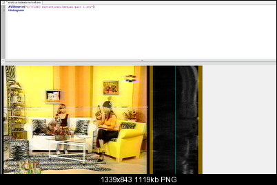

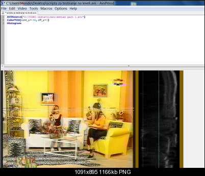

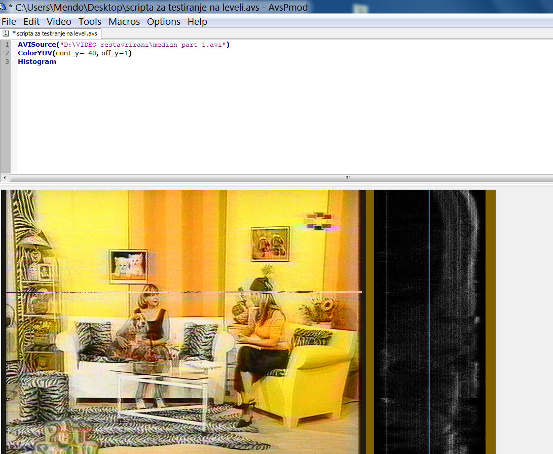

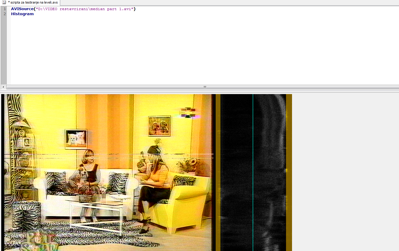

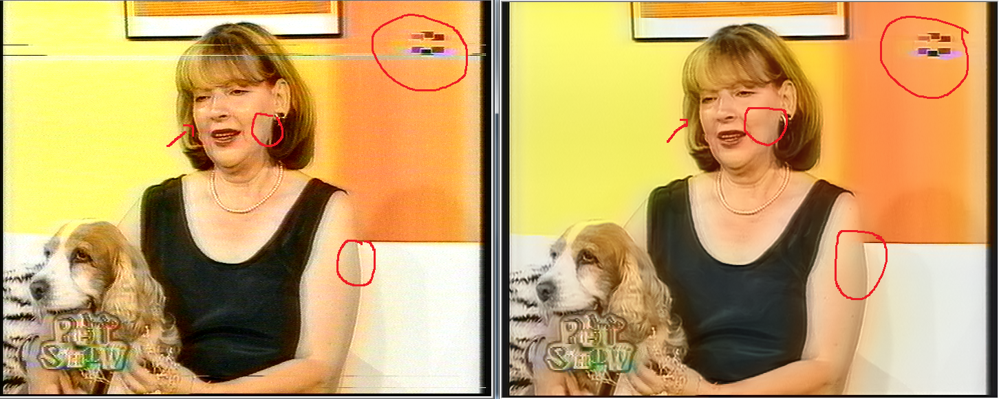

  2. I wanted to thank all the people that contribute to this project although in the other tread that I post about the same problem and this sequence long ago a lot sad that its incorrigibly. It was important family footage on two separate tapes that I don't have them anymore.
    I started with the histogram view in avisynth and corrected the levels ( there were a lot of superwhites and little superblacks)
    Then i used the median script from jagabo ( i had recorded 5 separate recordings before the tapes were ruined ) and from there used poisondeathray script about drop outs ( I deleted the removegrain part as suggested by poisn because the filter took too much detail ) and let it fry for a long time ( 0,78 fps ).
    After that I opened vdub and for my surprise the camcordercolor denoise filter worked brilliantly on that color bleed and on same flakes on the people's faces that any other noise reduction failed( including neatvideo) and I didn't noticed any ruining of the detail. On top of that I used neat video for final touch and some color mill. So here are the results what you guys think
ID:	11334Click image for larger version
  3. That's a good job i'd say, your earned the "restoration of the week" prize.
    For best results you should do everything in avisynth
    The black shirt look too bright or i dunno, smtg's not ok with the blacks
  4. That's a good job I'd say, your earned the "restoration of the week" prize.
    Thanks master and for your help also.
    Hm i think also ( back to sketching board . I find levels adjustment still challenging If you can see by the pictures there was some clipping and I used 40 because on other place was even worse maybe something got screed with colormill I don't know I will have to check. Also I think I can solve the pink bleed ( I'm working on it now, no Photoshop no frame by frame editing just avisynth and vduv) and will try to deghost ( as conservative as possible to preserve the details and maybe some final sharpening with msu smart sharpen ). I think that the tape came up pretty ok ( i was not expecting it ) even the other one with interview came up ok, and I was ready for disaster.
    I hope it can help others with similar drop outs/ bleed problems.

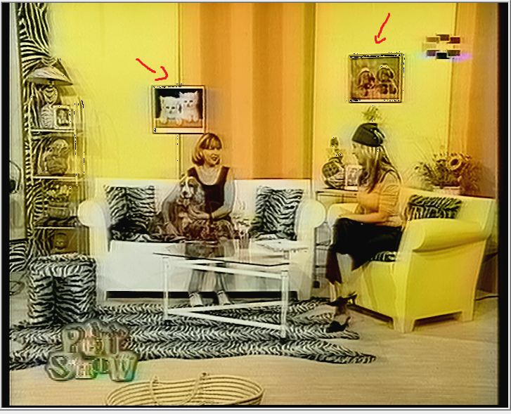

    O and because this is just hobby for me ( only personal and relatives ). My friend has asked me to do some conversation job for him but I told him to go to professional service because he has only 3 tapes. The "pro" used ( I was there) Camacrown VCR (wtf) with composite cables in to Easy TV capture card ( bt878) and captured in pinnacle studio 8 ( mpeg2 dvd compliant software capture) then burned the file ( with same software) on dvd and give to my friend ( although the price was very cheap only 2$ for a tape. I stared to laugh and tell him to come to my house and we can do it for free and much much better ( only when i have the time and patience). I'm impressed as how people can make money out of nothing ( I don't even want to mention their expertise and their experience ) and here on this site there are people that can put even real (not "real") pros ashamed and they help as a lot for free.
  5. Banned
    New York, US
    Nice work on the noise and damage, but these images look odd because contrast (brights) are too high and midtones are too high on the rgb scale. They will look burned-out when played on TV.
  6. Nice work on the noise and damage, but these images look odd because contrast (brights) are too high and midtones are too high on the rgb scale. They will look burned-out when played on TV.
    Surprisingly it looked ok on 42 inch Samsung lcd but i get your point, odd thing is that if I look at histogram ( or vectorscope in avisynth ) there are superblacks and superwhites ( the reason i suppress them is because i do conversation to rgb so i will lost precision and the picture even original on vcr looks burned out contrast ) but look ok on the eye ( corrected with internal pci proc amp during capture ), if I correct them then it look bad on the eye but ok on the waveform go figure.
    Can you suggest something based on the picture or you can download short sequence of the cleaned material mjpeg http://www.mediafire.com/?wewpypysw6rsnh2
    I will try in sony vegas or adobe premiere ( i think they have better color correction filters )
    any suggestion about color correction is welcome

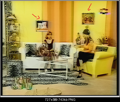

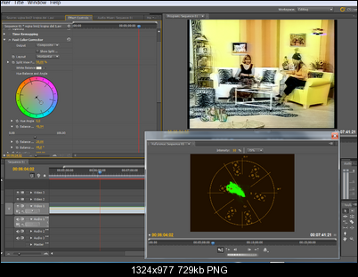

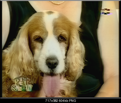

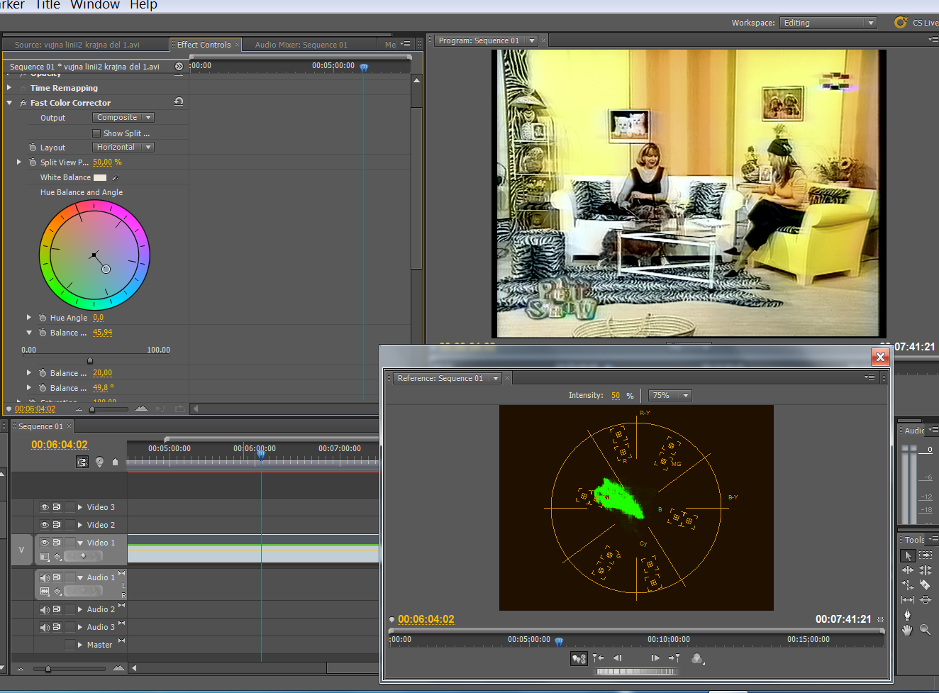

  7. 1) Yellow looks too hot for me in that scene - it's broadcast "illegal" on a vectorscope . So you would desaturate yellow slightly (or use some sort of "broadcast legal" filter) - otherwise chroma clipping will reduce level of detail
    But the previous scene is ok in terms of vectorscope (with closeup of the dog)
    2) Be careful about mjpeg - you can get completely different results depending on what decoder you are using
    e.g. ffdshow or libav based decoders will decode full range - so you will get Y' illegal, Cb illegal - So luma and chroma clipping
    But something like picvideo will clip levels - completely different results . Others will clamp levels - different again

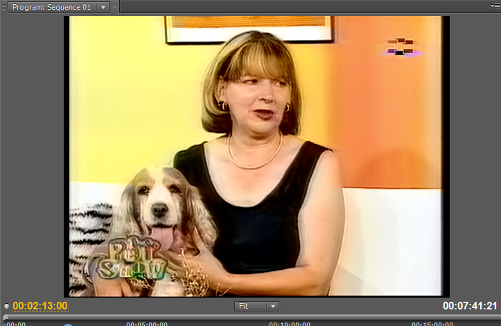

  8. Thanks poisondeathray yea i know about mjpeg but I was only uploading for lower sizes for download instead of more compressed format like mpeg ( I keep all my material as lagarith on hard disk even after h264 compression which I do in recent times instead of the DVD format which is bulky and inconvenient and put them on flash drive to watch them on lcd tv )
    I lowered the yellow a little bit it seems that the studio background and the host chair are the same color and the white black carpet is terrible so it's not happy scene
    The black looks washed out i changed to more black ( but now the contrast is up and its looks a little burned on ) picture above in premiere. By the way the previous post pictures are from unclean video, so to strait illegal's colors and contrast before all the processing

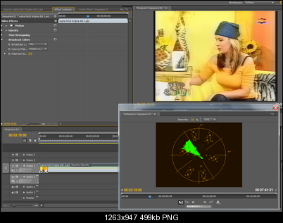

  10. You use selective color correction, otherwise if you decrease yellow , the other colors will be affected too (e.g. "white" will no longer be white) . For example, in that 2nd scene, I would narrow in on the yellow range and just selectively desaturate that
    How to do that i am little lost ( is there only one of the rgb channels that i can work at without affctin the others )what filter you suggestClick image for larger version

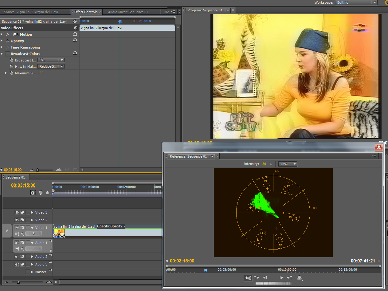

    Here is screen of premiere and yellow seems way illegal
  11. premiere has either "broadcast colors" effect, or you can use " three way color corrector" or "rgb color corrector" by using "tonal range" parameter ... I'm sure there are other ways as well. Most effects are "keyframeable" , so you can adjust over time or by scene
    Have a look in the help pdf (it's downloadble from Adobe), there are instructions and pictures
    http://help.adobe.com/en_US/premierepro/cs/using/WS118C587F-B312-4268-B0C5-A7E722E25C92.html
  12. Another way you might be able do it is in avisynth with tweak, using starthue and endhue , this way you can stay in YUV
    http://avisynth.org/mediawiki/Tweak
    You might use Trim() or ApplyRange() to limit the effect of filters or apply to sections
    (Personally I find color work easier to handle in RGB)

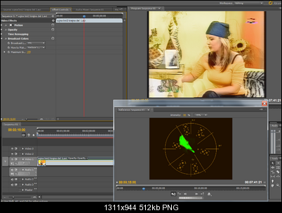

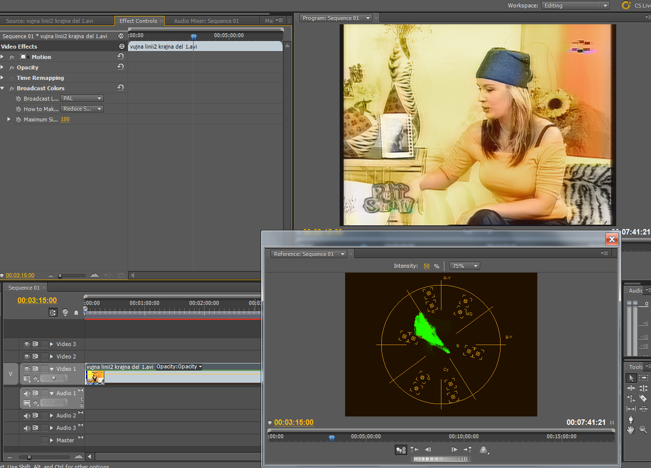

  13. I used broadcast and I'm not to satisfied
ID:	11358Click image for larger version
    http://help.adobe.com/en_US/premiere...722E25C92.html
    I will try that now thanks
  14. Originally Posted by mammo1789 View Post
    That's the problem with any "automatic" filter, you usually don't get as good results as manual with your own eye
    But can modulate any effect, e.g. use 2 layers, top layer with effect applied and adjust the opacity of the top layer
    The filter itself has settings too, e.g. you can alter the way it handles clipping and level you might want it at 105 instead of 100 for example, or you might want it to affect luminance instead

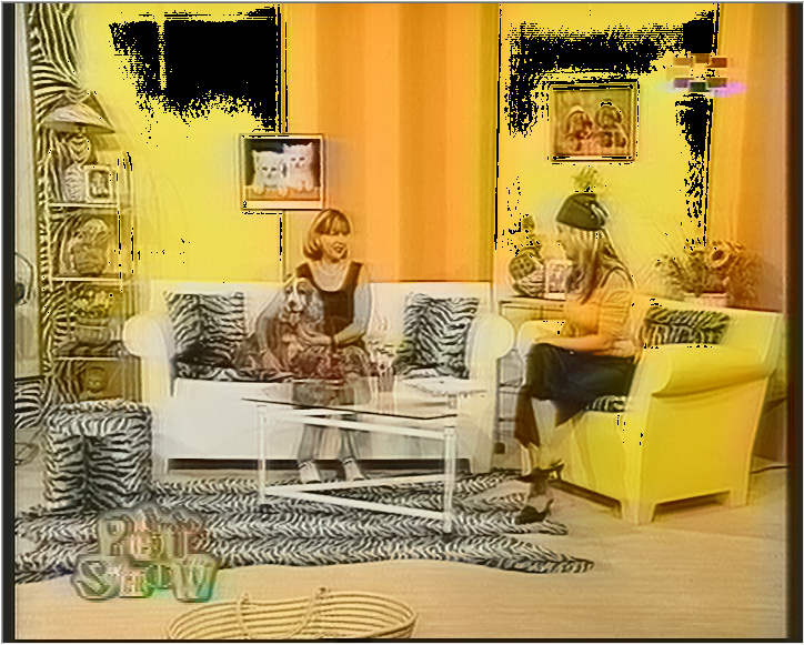

    Correcting levels and color from home video using color wheels is darn nigh impossible. Home video is notoriously nonlinear in levels and color response (e.g., orange skin and green blacks are not unusual). Color wheels correct one color and un-correct the other two at the same time. The way to get it right (and make it easier on yourself) is to learn to use gradation curves, to read histograms, and to use your software's pixel sampler to check area colors.
    The samples posted have midtones shoved to the bright left and highlights blown out (with crushed darks). It's not ferasible to correct colors without first making general corrections in levels, which are tweaked as colors are brought into line.
    I don't have the original source (which was repaired, and a nice job it was), but this previously color-corrected sample posted is beyond further correction, mainly because bright red has been set oversaturated. More green is needed in the skin tones, but that's impossible without turning the dog green. (After Effects. Premiere Pro has a similar gradation curves control).
    [Attachment 11360 - Click to enlarge]

  19. The way to get it right (and make it easier on yourself) is to learn to use gradation curves, to read histograms, and to use your software's pixel sampler to check area colors.
    I'm learning that right now i will see the effect of it
    You are talking about the last samples right? they were just a test in premiere or the original footage i think i fix the levels there ( not the colors) .
    http://www.mediafire.com/?o7e74grcw6p7m43 here is the original source uncleaned and uncorrected pure lagarith ( converted to mjpeg yuv).
    So do you generaly mean is better to correct the colors ( levels i assume will be corrected before to avoid crushing of blacks and whites during rgb conversation) before the cleanup or after. And can you tell me what preferences to use on this clip to get colors right
    Thanks sanlyn

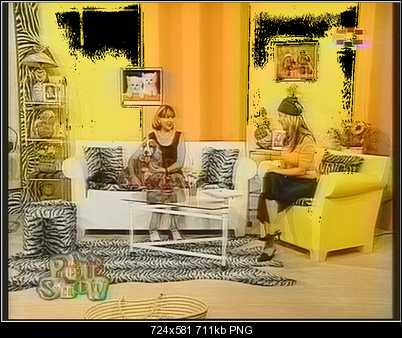

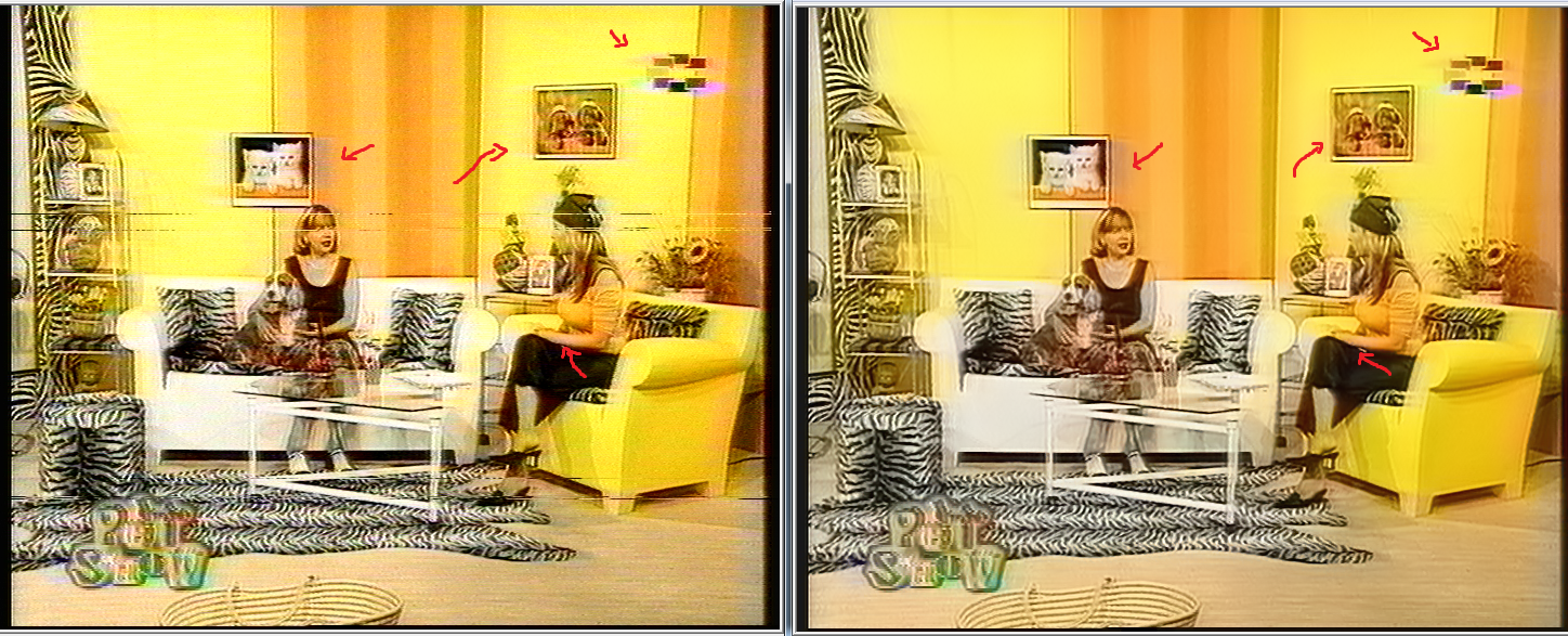

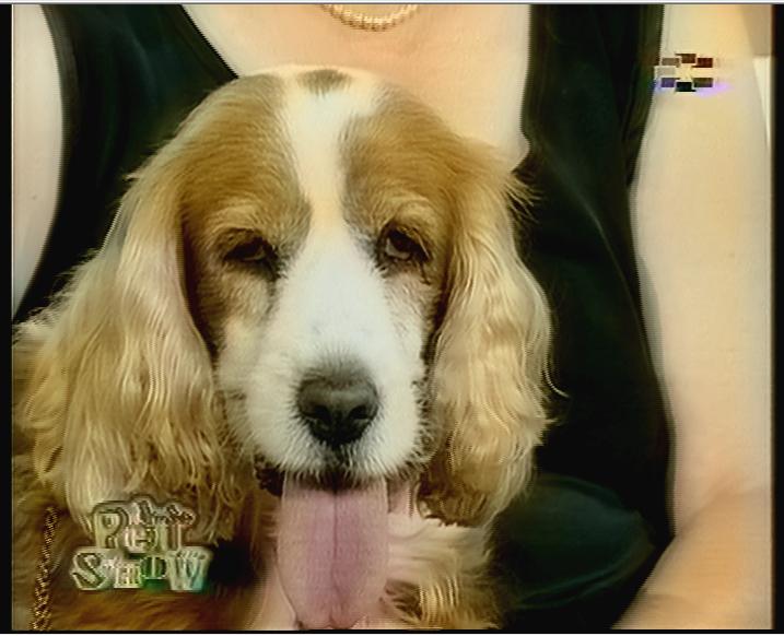

  25. Ok one more round before bed Click image for larger version
ID:	11373Click image for larger version
ID:	11375Click image for larger version
    the first picture is from corrected levels (scene 5 with the host) second one is original cleaned and properly pc601 converted to rgb without color correction and third is scene 2 dog cleaned and color corrected.
    As you can see ( with vdub color tools hot pixel scan to black pal 255 i wanted to see where illegals are happening precisely so) color correction using curves p brightness and contrast and broadcast colors set to desaturated ( it desaturated yellow ) 105.
    It seems that black is back and I didn't wanted to go to much blue cast.
    As you can see i will have to make separate color correction for close up scenes and studio scenes ( because while dog scene is right and legal the studio has some illegal pixels i guess)
    This time i used the temporal filter in neatvideo( 1 threshold 15 Y 53% 100chroma) so its little more blurry than before ( because i think i used temporal before in avisynth and this was just double but I'm sleepy.
    Any suggestions welcome
    I came along way from start but Rome was not build in a day i continue the "fight" with this tape tomorrow

    I don't know why getting a basic levels correction in YUV seems so complicated. Full-scale color work on problems like this video ought to begin with some basic adjustments in YUV, if for no other reason that to keep detail in darks and brights. I worked a bit on setting basic levels in YUV with Video2.avi. You should crop off black borders to keep from affecting the left-hand edge of Avisynth's "Levels" histogram. The borders can be restored later. Here is the script I used to open the AVI with no YUV corrections:
    DirectShowSource("J:\forum\hot_color\video2.avi")
    Crop(8,4,-8,-4)
    Histogram(mode="levels")
    # --- restore original borders ---
    AddBorders (8,4,8,4)
    ConvertToRGB32(matrix="Rec601",interlaced=true)
    The image in VirtualDub shows the top part of the histogram with luma levels banging into the left and right dark borders, which is what you want to avoid. In RGB, those areas will be crushed, losing detail.
    [Attachment 11391 - Click to enlarge]
    Here is the script I used to adjust levels, tame red a little, juice up blue a bit, and tame saturation. Not a lot of complicate color work, just basic level adjustments. Can work with more detail from this point, using any number of color tools:
    Crop(8,4,-8,-4)
    ColorYUV(gain_y=-12,gain_v=-5,gain_u=+10)
    SmoothLevels(0, 0.75, 255, 16, 235, Limiter=0, TVrange = false)
    SMoothTweak(saturation=0.8)
    The result is levels that are more workable. One can tweak the COLORYUV and SmoothAdjust() values to suit. Still a lot to do, though.
    [Attachment 11393 - Click to enlarge]
