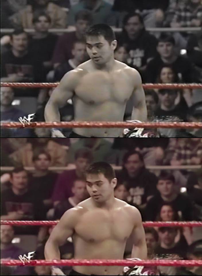

  20. Originally Posted by holygamer View Post
    Hi, I tried converttoyv12() but it still crashes. As far as I can tell my script is correct, can you see anything wrong with it?:
    This is your script, as it, running here: (only added Stackvertical)
    I think the problem is NOT concerned avs script itself, but something wrong and weird with your system.
    Thank you.
  21. Pure hypothesis:
    Perhaps the fact that the .vdf is inside the avisynth plugins folder is confusing avisynth somehow, although i don't see the reason why.
    Try to place them elsewhere.
    For the crop and addborders you should put something like this imo:
    Crop(0,0,0,-16)
    AddBorders(8, 8, 8, 8, $000000)
    another error spotted:
    converttoyv12() should in fact be converttoyv12(interlaced=true)
    N.B:
    You should only load colormill once but that's not a problem generally to load it several times

  23. I think i have found the root of your problem: the syntax.
    Should look like this, without space between cdd & the ":
    LoadVirtualdubPlugin("C:\Program Files\AviSynth 2.5\plugins\Camcorder_Color_Denoise_sse2.vdf","ccd",1)
    When i paste the code here it add and extra space (Bug ?)so be sure to remove it
    Full script:
    Mpeg2Source("E:\1\colour test.d2v", CPU=6,info=3)
    DeGrainMedian(limitY=2, limitUV=3, mode=1, interlaced=true)
    converttorgb32(interlaced=true)
    LoadVirtualdubPlugin("C:\Program Files\AviSynth 2.5\plugins\ColorMill.vdf","colormill",1)
    colormill(25700, 31076, 21604, 25700, 25700, 25700, 25734, 25700, 25700, 25700, 25700, 25700, 25700, 1124, 5)
    LoadVirtualdubPlugin("C:\Program Files\AviSynth 2.5\plugins\Camcorder_Color_Denoise_sse2.vdf","ccd ",1)
    ccd(41,1)
    colormill(25700, 25700, 25700, 25700, 25700, 25700, 25700, 25700, 25700, 25713, 25700, 25700, 25700, 1124, 5)
    Crop(0,0,0,-16)
    Tweak(Bright=-0, Sat=1.5, Cont=1.0, Hue=0.0, Coring=False)
  24. I already had that script you posted without a space. The forum software added the space!
    Could you please tell me the answer to my questions in the previous thread here: https://forum.videohelp.com/threads/343257-How-to-Fix-Patchy-Colour-with-Avisynth?p=214...=1#post2141092
  25. The last argument to AddBorders is the color -- $000000 is black.
  26. if this script dont work i dont see man.Try with CPU=0 i get funky color effects with CPU=6
    When you open it with Avsp does it work? What error does it return if not
  27. When I open it in Avsp the video shows without giving an error.
    Why do you add black, I thought the borders are already black?
  28. Ok script's working, case closed (finally!)
    borders can be any colors: red, white, dark black (0rgb), lighter black (7rgb) and so on
    ex: $101010 (black 16rgb)
  29. Not quite case closed! The video displays without errors in AvsPmod but it just crashes without error in HC Encoder! That has always been my problem.
    Why did you add black when the borders are already black?
