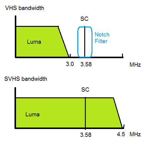

  4. Member edDV's Avatar
    Mar 2004
    Northern California, USA
    Originally Posted by alesco View Post
    4) just to be sure - S-Video input is useless (does not change the quality) if the source VHS is not SVHS, right? Could it help preventing a/v synchronization problems (see question 2)) or enhance audio quality?
    Not true. Both VHS and SVHS record luma and chroma separately on tape (aka color under process). S-Video keeps luma and chroma separate from tape to A/D. Composite video mixes luma and chroma (modulated subcarrier) to one shielded wire. At the capture card the luma and chroma must be separated (Y/C separation) before A/D.
    However, since VHS luma is limited to 3 MHz (chroma subcarrier at 3.58 MHz), Y/C separation can be accomplished with simple notch filters. SVHS has luma bandwidth out to 4.5 MHz, hence needs a more complex comb filter for Y/C separation. This capture card filter can be avoided if S-Video is used.

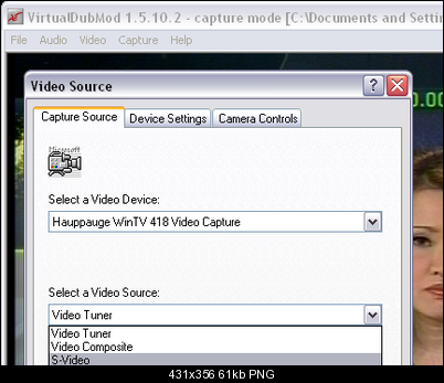

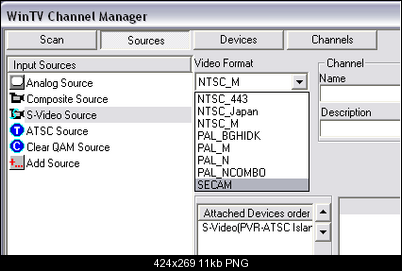

  13. Member edDV's Avatar
    Mar 2004
    Does S-Video play in color to a monitor?
    Hauppauge cards need to be set to include S-Video capture in the WinTV Channel Manager Sources tab.
    And then select S-Video in Menu Channel Select.

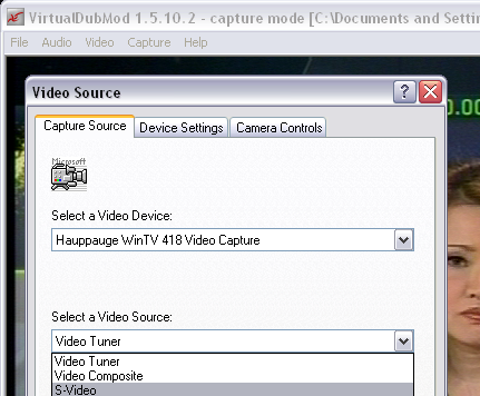

  14. Member edDV's Avatar
    Mar 2004
    Or after setting up the source in WinTV-Channel Manager, select it in VDub
