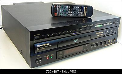

    Pioneer did make them towards the end of the laserdisc days as a way to try to squeeze a few more sales out of people who wanted to hedge their bets but they were very expensive. If I remember correctly you had pay over $1000 for one.

    Not me. I bought it used a few years ago.
    Nov 2005
    I'm have 0 experience with LD players but this scenario sounds like your trying to capture PAL and the universal VCR or BMIP is setting it NTSC...I do know that i have played PAL discs on a NTSC player and they all come out black and white and fuzzy
    maybe the BMIP has a internal NTSC setting...not sure
    Pioneer DVL V888

    I own the Pioneer DVL-919 and it works exactly as edDV describes. In the setup menu for the player you can switch between S-Video and Component video outputs. When set for S-Video output the Component video is turned off and you only see black and white. When set for Component output and you play a Laserdisc, which will only output on S-Video or Composite, the Component video output is automatically turned off.
