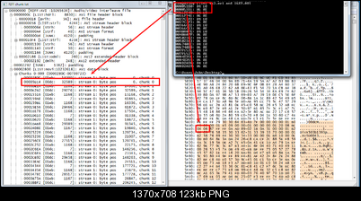

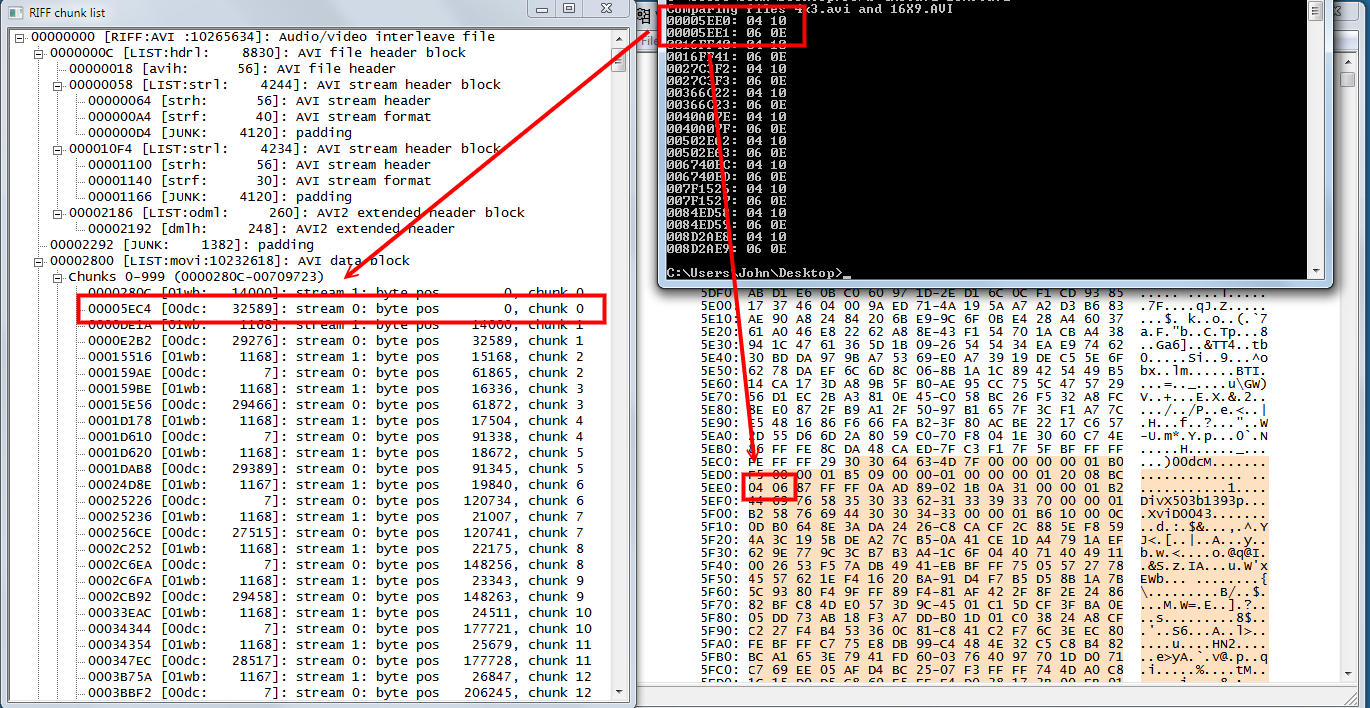

  6. Create two files with Mpeg4Modifier, one 4:3 the other 16:9. Then
    fc/b file4x3.avi file16x9.avi
    But in the end, you're going to have to parse the AVI structure and xvid video structure if you're looking to properly patch files yourself.
