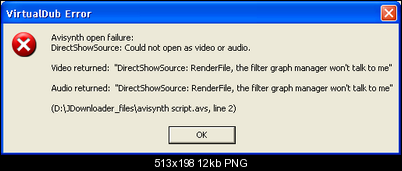

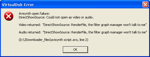

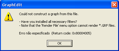

    I'm trying to open a mp4 video with Vdub. DirectShowSource does't work. It says:
    Asking Google about this error, I came to:
    "This is a common error that occurs when DirectShow isn't able to deliver any format that is readable to AviSynth. Try creating a filter graph manually. See if you are able to construct a filter graph that delivers any output that AviSynth can open. If not, you might need to download additional DirectShow filters that can deliver correct material. If you can play the graph in GraphEdit, make sure to remove the video and audio renderers, before saving the graph and opening it in AviSynth. Some examples can be found here."

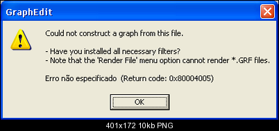

    How to find out wich filter is needed and wich one is behaving bad? GraphEdit says:
    I can open AVI and even RMVB files using DirectShowSource in Vdub and in GraphEdit. But none mp4 files...
    Thank you.
  2. You need a DirectShow MP4 reader/splitter and decoders for whatever codecs are used in the file. Try Haali for the reader/splitter. MediaInfo will tell you what decoders you need. But it's likely h.264 and aac. Both of which you can get from ffdshow.
    FYI: using the DirectShow plugin for VirtualDub is asking Windows' DirectShow to open the video and decompress it. So DirectShow filters for the file type and codecs must be installed.

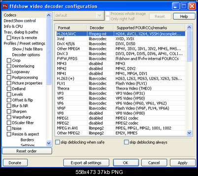

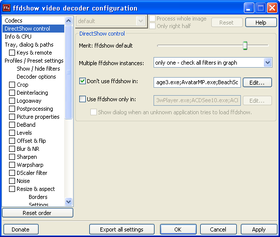

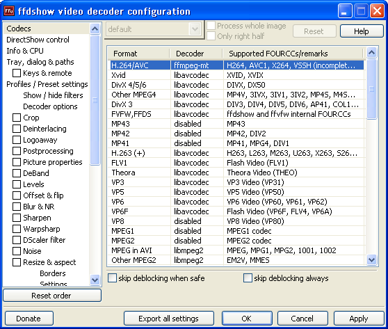

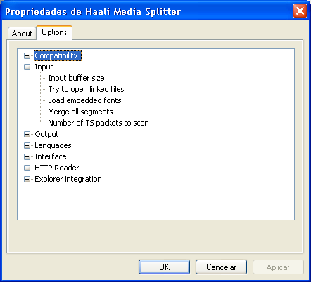

    I have K-Lite codec pack installed. Ffdshow and Haali are available:
ID:	10745Click image for larger version
    How to config them properly?
    Thank you.
  4. Another question:
    Why I can open all mp4 videos using Avidemux? And I can play any mp4 using any players.
    Answering my own question, is it because Avidemux don't use DirectShowSource to open files. Maybe it has its own filters. And players has the same, too. (ffdshow?) Is this answer correct?
    And why GraphEdit cannot open? I thought GraphEdit would be able to open any video to show the codecs and filters diagram.
    Also, I cannot convert mp4 videos to RMVB using EasyRealProducer. I guess it is because the same problem with DirectShowSource filters.
    So, question remains:
    1 - How to set ffdshow and Haali?
    2 - Why Avidemux open without problem?
    2 - Why GraphEdit cannot open? (We depends on it to know the diagram)
    Thank you.

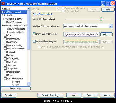

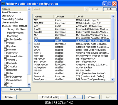

    Make sure that the AVC (h.264) decoder in ffdshow is enabled (Start -> All Programs -> ffdshow -> Video Decoder Configuration... Codecs in left pane, h.264/AVC in the right pane. Same for the AAC decoder, Start -> All Programs -> Audio Decoder Configuration... Codecs in the left pane, AAC in the right pane.
    If you are using 64 bit Windows be aware that 64 bit programs require 64 bit codecs and filters, 32 bit programs require 32 bit codecs and filters. The two systems can't see each others' components.
  6. Originally Posted by jagabo View Post

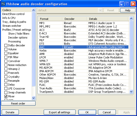

    Yes. It already has what you said. Look:
ID:	10747Click image for larger version
    H.264 decoder has ffmpeg-mt/libavcodec/Disable options. Default is ffmpeg-mt. I tried libavcodec and Vdub return the same error.
    On details: "H264, AVC1, X264, VSSH (incomplete), DAVC, PAVC. ffmpeg-mt is multithreaded. libavcodec (experimental)". Any clues from here?
    AAC decoder has libfaad2/Disable options. Default is libfaad2.
    My system is 32 bits, WinXP SP3. K-Lite codec pack.
    Thank you.

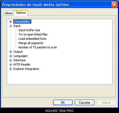

    Jul 2009
    Spain
    In the Haali configuration dialog, under 'Interface', set 'Show tray icon' and 'Display error messages' to 'Yes'.
    This will show if Haali is being used and allow you to see any error messages it produces.
  8. Gavino,
    I set 'Show tray icon' and 'Display error messages' for Haali. Trying to open the avs using Vdub I got the Vdub error, but no Haali tray icon nor message. Seems that Haali is out the party.
    Thank you.
  9. I would uninstall KLite (and hope that your system is completely screwed up already) then install just Haali and ffdshow. If you ever need any other codecs download and install them individually.
  10. DECEASED
    Jun 2009
    Heaven
    FWIW: not all applications (including Avisynth) attempt to build DS graphs in the same way.
    When Gabest's Matroska and MP4 splitters are registered, Graphstudio often/always prefers them, even when their merit is set to "DO_NOT_USE"
    Haali, in his infinite wisdom , tried to fix that issue by making his splitter exceedingly power-hungry , which at times freezes MPC-HC by means of 100% non-functional graphs
    Over here, LAV Splitter for MP4s and SolveigMM Splitter for MKVs have given me the best results so far.

  14. The video codec is xvid and the audio codec is mp3. Make sure those are enabled in ffdshow.
  15. Jagabo,
    you won't believe!
    After your suggestion I checked ffdshow decode configuration once more (I've seen this screen since I left the bed today).
    Of course, Xvid was enabled, using libavcodec.dll. The options are libavcodec and Xvid. I changed to Xvid and tried. Error again...
    But... But... I don't know why, I decided to change this option to Disabled. Nonsense.
    I tried again and, BINGO! It is running right now! No error!
    Is it possible? More confused yet, but very happy!
    Thank you.
  16. On system tray I have ffdshow audio decoder and DirectVobSub icons. Now, I realize that this video has a subtitle with same name. Maybe DirectVobSub is conflicting with ffdshow. Make sense?
    Edited:
    I stopped the conversion before finish. Result video is upside down (!!!).
    I'll remove the subtitle and enable back libavcodec.
    Edited (2):
    It works! Removing subtitle file and bringing back libavcodec, conversion is plain and result video is standing.

    1 - Installing new Haali Splitter I could open MP4 video using Vdub. (good)
    2 - Renaming the subtitle file to another name different from the video file I could convert an AVI file to RMVB redirecting DirectVobSub encoder to Xvid from ffdshow, avoiding some kind of conflict. (good)

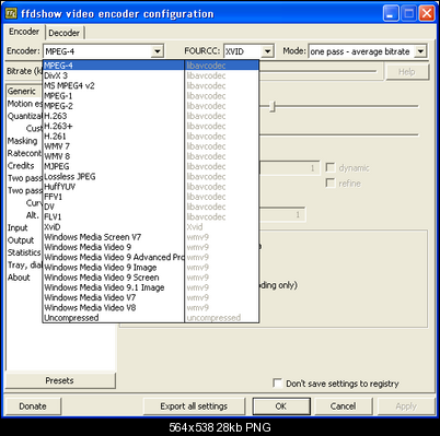

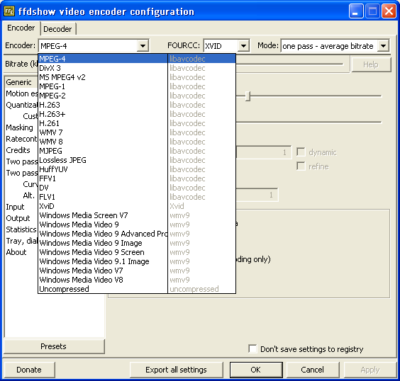

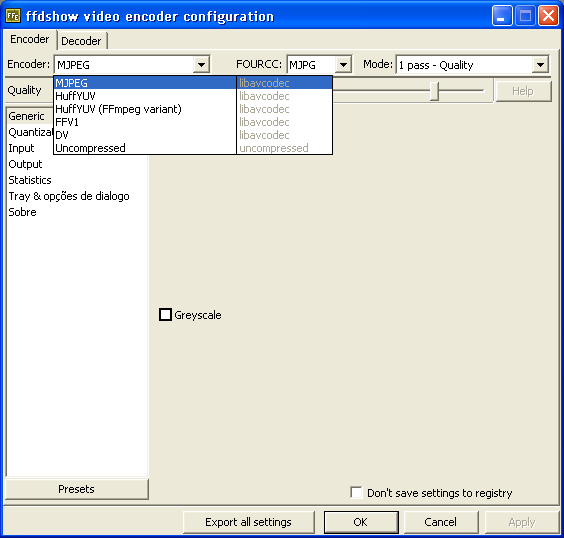

    After update I have this:

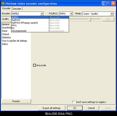

    Only lossless encoders... Where are MPEG-4, DivX-3 and others encoders?
    How to use ffdshow codec inside Vdub to use MPEG-4 and others VFW encoders? (bad)
    At FOURCC I had XVID, FFDS, FVFW, DX50, DIVX and MP4V. Now I have just MJPEG.
    At left panel I had many options to set Quantization, Masking, Ratecontrol, Two Passes Mode and others.
    Now I have only Quantization.
    The update of ffdshow walked back? Or I miss something?
    Thank you.
  19. Many ffdshow vfw encoders have been removed . Either use old ffdshow build (not recommended), or use another encoder
