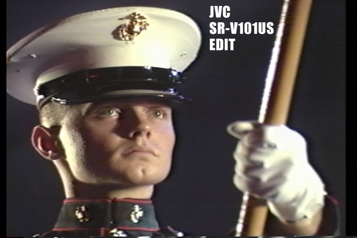

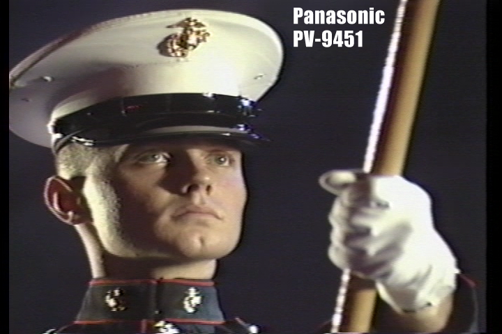

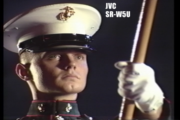

  2. I redid a few images from earlier, trying to line each of them up in a way that you can open each in an individual tab and flip through them using CTRL + TAB (in Firefox at least) and see the changes. From left to right is the Panasonic PV-9451, JVC SR-V101US in edit mode, same VCR in NORM, and the JVC SR-W5U.
    Edit: if that doesn't work, downloading them to the same folder and using the Windows Photo Viewer and the left and right arrows works well too.

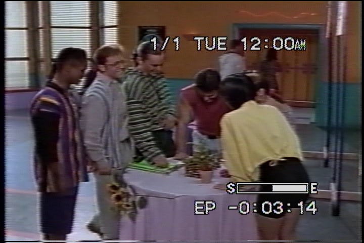

    @sanlyn:
    This a random bump, but I figured it would be better to ask in a dead thread discussing VCR picture quality rather than derail dianedebuda's thread with my own query about a machine that sanlyn has mentioned a few times.
    SONY SLV-585HF

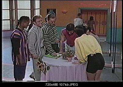

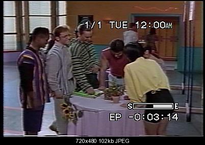

    I picked up one of these from the thrift store hoping it would perform similarly to my SLV-750HF that died. SP recordings look just fine, but EP tapes look horribly overprocessed. Edges of objects appear serrated; I believe you have referred to this effect as "mice teeth" when talking about other VCRs with the problem.
    Lowering the sharpness control to minimum doesn't help, and turning on EDIT mode seems to output the same picture as setting sharpness to middle.
    Here's a comparison between the SLV-585HF (sharpness min) and yet another Sony, the SLV-779HF from 1999 (don't remember the settings).
    How does yours fare with EP recordings made on other machines? (The images are from a budget retail release.)
