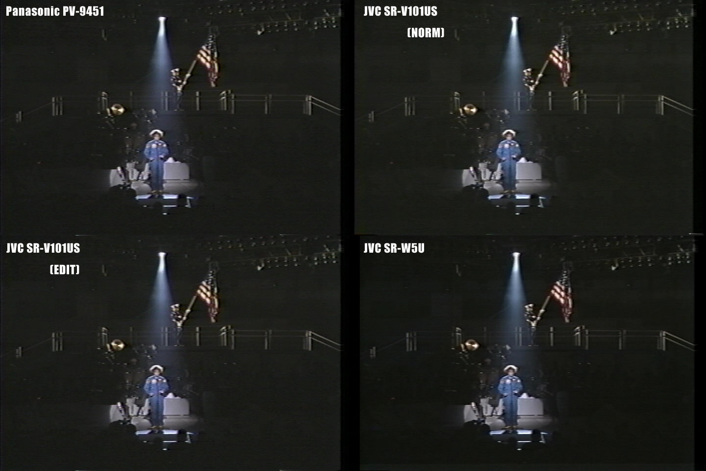

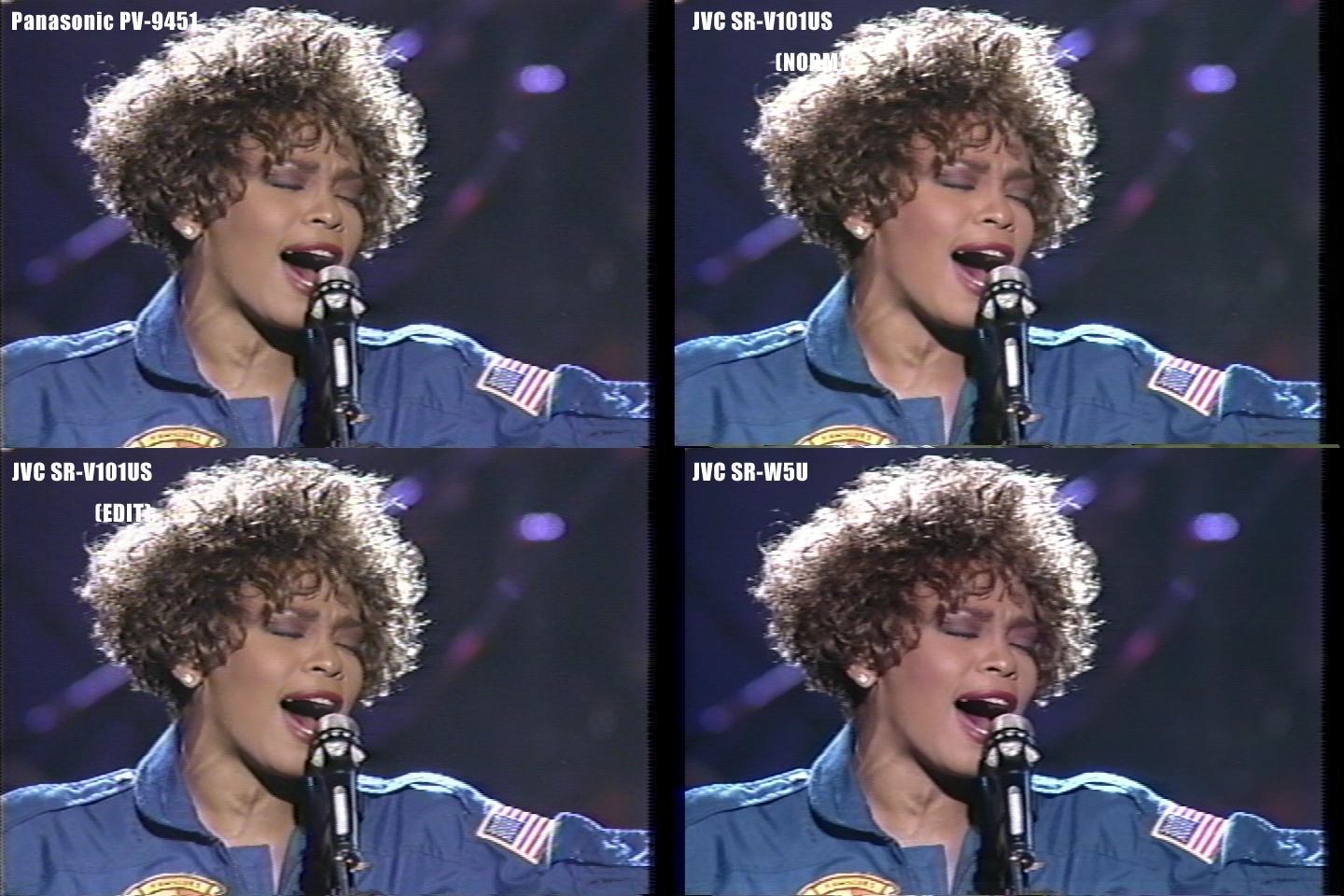

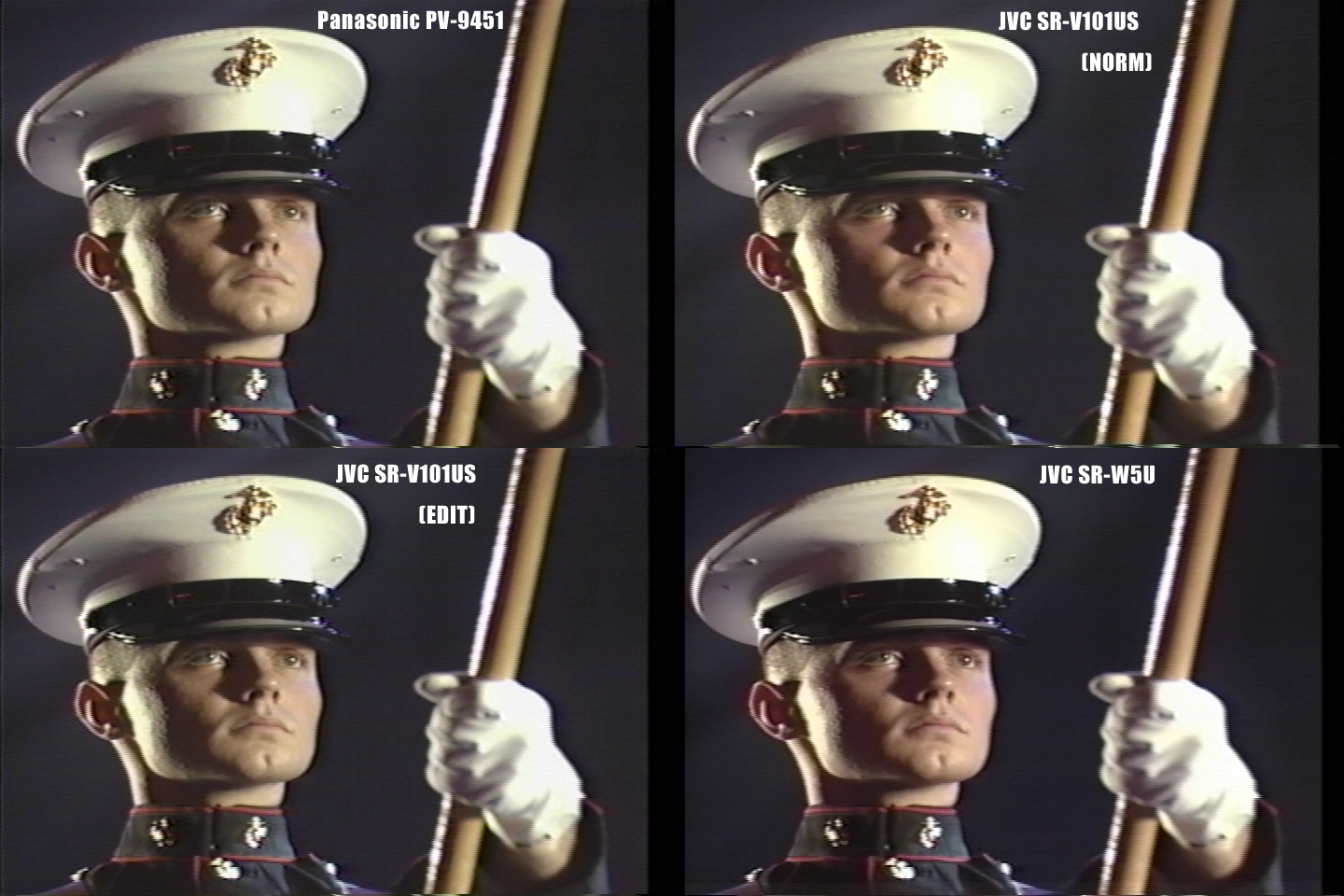

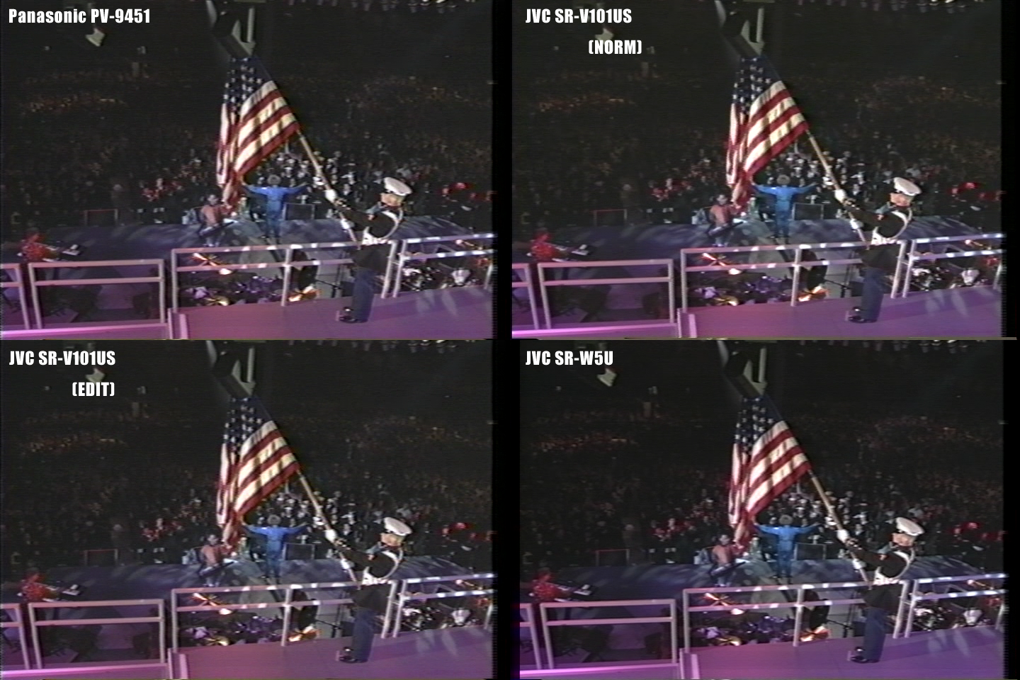

  19. Just for fun, here are a couple of screenshots to compare the Panasonic PV-9451 to a couple of other VCRs with a real tape. I may have messed up the cropping on a couple of pictures, but they are all the same frame.
    It's pretty easy to see how pumped up the sharpness is and the grain that results in even a relatively noise-free image. The noise distribution is really apparent upon zoom-in in the upper right hand corner of test5.bmp.
    I'll try and do an EP tape later to show the oddly large amount of dropoff in the PV-9451 image in respect to the other decks.
