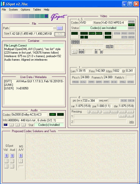

    Back with yet another query about my DVp5990. Tried watching a flic tonight that is 1.49 gig in size, and for whatever reason it stops at approximately the 1:05 mark, then the player immediately jumps to the next flic in the queue. I was using a 4 gig Dane-Elec thumb-drive as a storage device for the AVI.
    Here's a G-Spot cap for anyone that might want to take a shot at it, and thanks to anyone taking the time with this.

    Post a MediaInfo report it has far more detail and information than GSpot in a more readable format. Use Text mode and you can simply select the text copy and paste into your post.

    I had a Philips player that had sometimes had problems AVIs that had been joined(as yours appears to be). My solution was to open it in MPEG4 Modifier and then resave it. Hope it works for you
  4. Kiwi, can you tell me what in the g-spot info indicates that it was a joined file? "Multipart Open DML?" Something I'll have to keep my eye out for.
