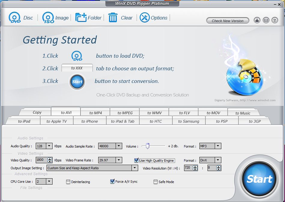

    Thank you usually_quiet, for your advice. I have attached the WinX DVD Ripper Platinum settings - I have taken the defaults except for the two boxes you see checked - and the information from MediaInfo on one of the converted files.
Name:	WinX DVD Program Settings.jpg

    WinX DVD Ripper Platinum has an FAQ page http://www.winxdvd.com/dvd-ripper-platinum/tech-faq.htm#12 which gives the following advice in the event that audio and video are out of sync:
    Please use "Force A/V sync"; in Advanced Setting to have a try. This feature is useful even if your original DVD's audio failed to sync with movie.
    Have you tried that?
    If there is one, you might also try just using the AC3 audio track as is. AC3 is a compressed audio format and does not take up a great deal more room than MP3 audio. Sometimes the type of audio can make a difference.

    Yes...I run with Force A/V turned on. Novice question: What is the significance of the DivX encoder over whatever encoder you use? I did not want specifically DivX - it's just how this software is set up.
