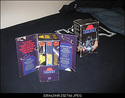

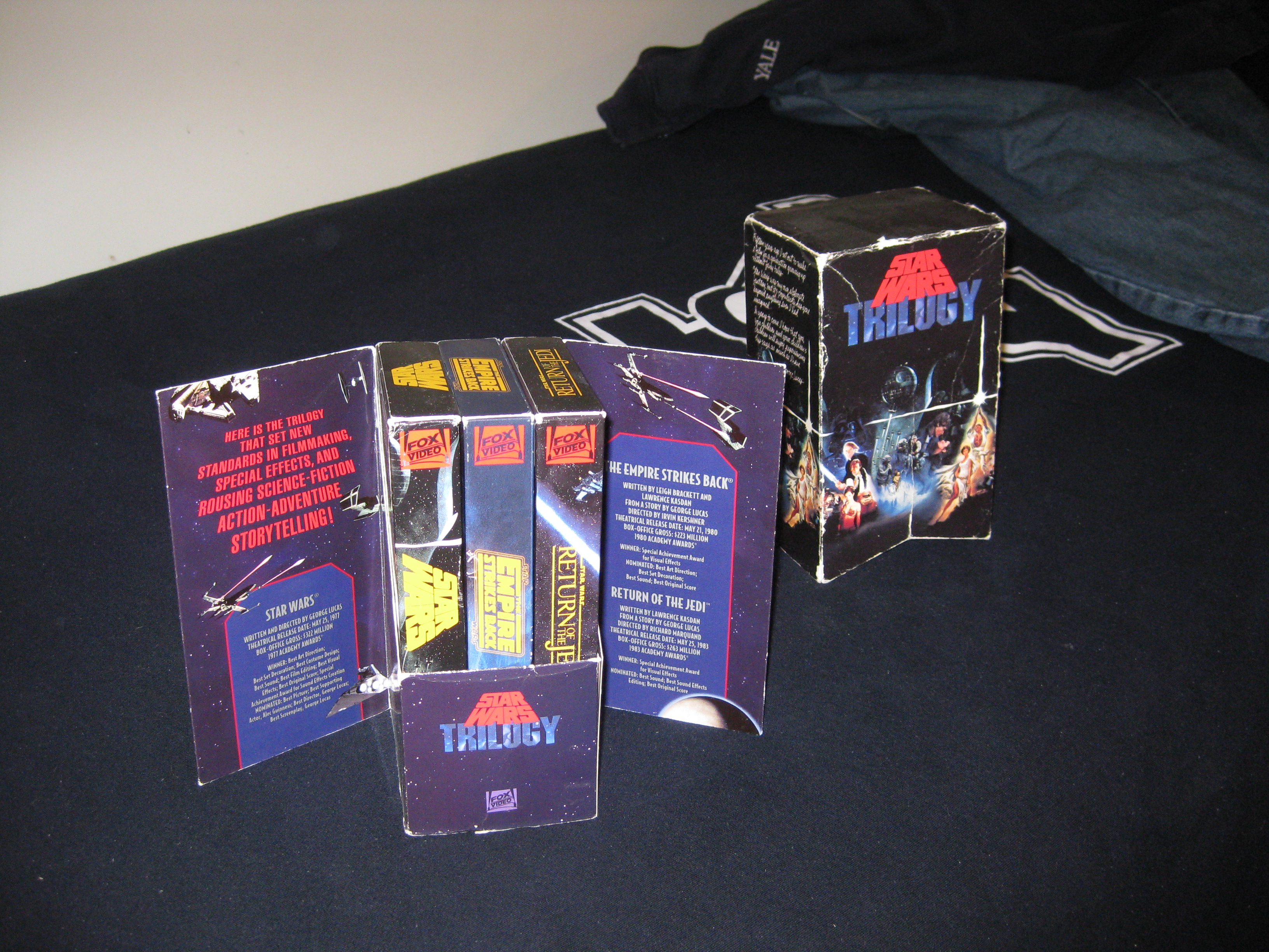

    4. For a majority of my VHSs, you may be right, but I'm sentimental and like the older quality of VHS tapes and want to "preserve" the versions of some of the movies I grew up with. Most importantly, I have these - original and un-ruined by "George":
Name:	star wars vhs.JPG
    Surely you understand the importance of the situation...

    For the tape trilogy you pictured, my advice is don't bother: the results will be pretty poor for various reasons specific to this tape set. Assuming what you're after is a DVD copy of the "original untampered versions" from the VHS era, you'd be much MUCH better off just buying the 2006 two-disc "limited edition" studio releases of each film, which include the "original" versions on a separate disc:
    http://www.ebay.com/itm/Star-Wars-DVD-2006-2-Disc-Limited-Edition-Widescreen-/22094401...item33714a2954
    http://www.ebay.com/itm/Empire-Strikes-Back-DVD-2006-2-Disc-Set-Limited-Edition-Widesc...item231935815e
    http://www.ebay.com/itm/Star-Wars-VI-Return-Jedi-Wide-Screen-2-DVD-Set-Limited-Edition...item35b8ff66e0
    Yes, you'll probably end up paying $60-90 for the three but it is the only realistic way to get a decent DVD version of the "original" theatrical releases. This was the only DVD or BluRay release to include the "originals," all other disc versions/packages/collections include only the "improved" updated/tampered/eff-up versions that zippy the pinhead has inflicted on the world. He has not changed his mind about this since 2006, if anything he has grown more stubborn and obnoxious about wiping the originals out of existence. So if you want them, grit your teeth and buy these specific DVDs. Assuming he never relents, these discs will retain their value.
    Of course if the updated versions do not bother you, you could just grab the cheapest DVD releases you can find. There are countless DVD variations of the "updated" trilogy available for as little as $5 apiece second-hand. I would recommend buying these over trying to dub the tapes: you can get away with tape dubs of "ordinary" movies and TV shows, but anything on VHS which relies heavily on FX or visuals, esp letterboxed widescreen, results in murky hard to watch DVD dubs.
