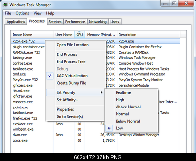

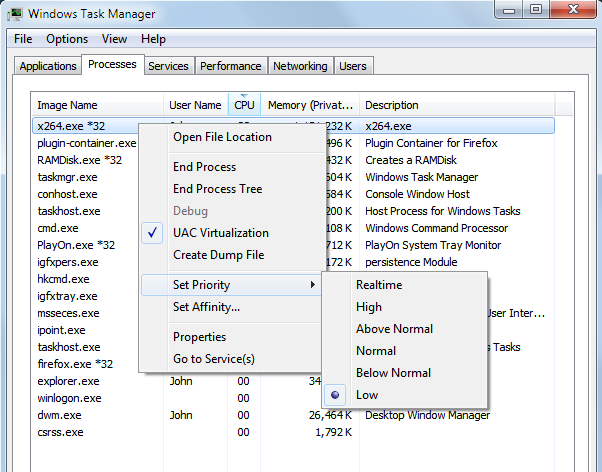

  7. Originally Posted by Seeker47 View Post
    If one rig is left to just a video job, and that job takes 70 minutes instead of 40, I won't care about it that much if I can keep working on something else -- plus web and email -- in the adjoining room.
    Just run the encoder at a low priority. You'll hardly be able to tell it's running in the background:
