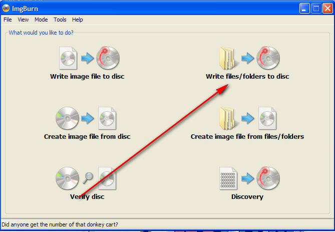

    I use Dvdflick - cannot get Avstodvd to work properly. After conversion use Imgburn
