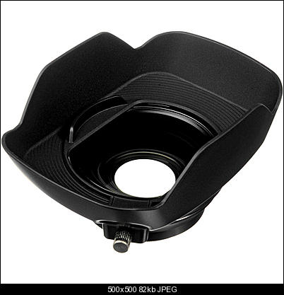

    The problem with consumer (and prosumer XA10) cameras is how wide is the wide end of the zoom. To make a wide view in a small space the lens needs to get physically larger. Pro cams need large lenses for this reason.
    Consumers want small camcorders so the trade off is constricted tunnel vision at the wide end of the zoom. The manufacturers promote 10x 20x or more at the telephoto end to distract you from what you should want which is a wider wide. The same thing apply s to still cams.
    The typical solution is to fit a wide adapter over the lens but these add barrel distortion to the image corners. Better than not using the adapter.

    http://www.bhphotovideo.com/c/product/751265-REG/Canon_4892B001_WD_H58W_0_8x_Wide_Converter.html

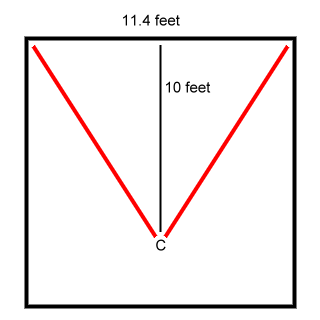

  5. The camera's view is a rectangular cone with the camera at the apex. Assuming the 11.4x6.4 foot numbers are correct, viewed from overhead (not to scale):
    The camera can't see anything outside that cone. It has no "peripheral vision".
