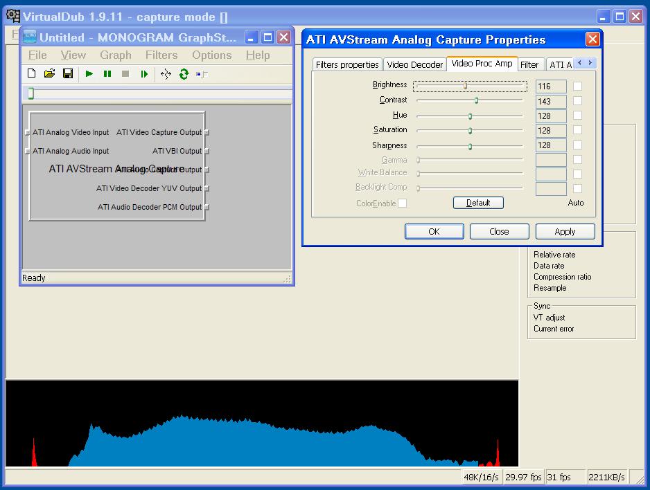

  2. That's not really VirtualDub's proc amp -- it's the capture devices proc amp. VirtualDub just give you access to it. You can access that control interactively using GraphStudio or GraphEdit. Add the capture filter and select its properties. Go to the Proc Amp tab. You will be able to see the picture changing in VirtualDub as you adjust the settings. VirtualDub's histogram display while adjusting the proc amp in GraphStudio:
  3. Banned
    New York, US
    Excellent, jagabo! Without the tools you mention, I do see the histogram OK in VDub but not the image changes. So it's some back-and-forth and stop-and-check fiddling without those tools.
