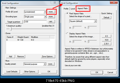

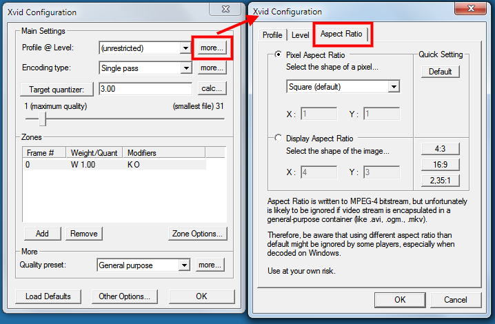

  7. If you use an program that gives you access to the Xvid dialogs you can specify either the pixel aspect ratio (shape of individual pixels) or the display aspect ratio (shape of the final displayed picture).
