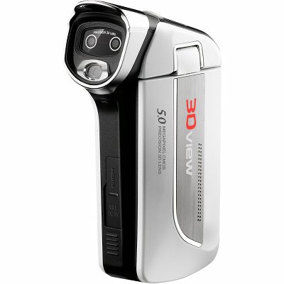

    just bought this thing and think i broke it already lol it turns on but screen goes black and i have no idea what i did the light works when i choose it but nothing else seems to work ******* weird anyone have any experience with this cam would love some help

    Scott; the lenses don't look far enough apart to give a proper 3D image. Shouldn't they be as far apart as human eyes? Maybe even further for an exaggerated 3D effect.

  5. Member Cornucopia's Avatar
    Yes, those lenses are quite close together. They're what's known as hypo-stereoscopic interaxial (smaller-than-normal), as opposed to ortho-stereoscopic ("right"-sized) or hyper-stereoscopic (larger than normal).
    What you'll get from this is:
    1. Gigantism (things LOOK to be larger in scale than normal)
    2. Flattened depth (pancaked balls, as opposed to spherical balls or enhanced "footballs")
    3. Shortened area of "3d-ness". The point at which things appear to be infinite/2D background will be nearer.
    4. Improved close distance 3d.
    So, basically, some good points and some bad points. Depends on what you intend to use it for...
    edit: note that some of those things can be adjusted in post, but those do tend to affect OTHER aspects as well.
