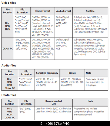

  10. Member edDV's Avatar
    Mar 2004
    Northern California, USA
    Originally Posted by Testiculese View Post
    Will an LG BD690 play the disk I have described? I know some formats will not be watchable.
    Sorry but this is important to me I have had HD crashes and lost really important home videos/pictures of the kids growing up. A HD crash and forgetting to backup your most important stuff really wakes you up.
    List the video/audio codecs and containers you have. Publish it here and ask users for a match.
    Download the manual for the players you are interested in and note the codecs, containers, resolution and bit rates supported. Then when you limit the field, ask for user opinions on that model.
    You are unlikely to find a player that "plays anything". The players are most likely to support h.264, MPeg2 and wmv-VC1 for video and AC3/DTS/Mp2/PCM for audio because they are part of the DVD/Blu-Ray specs. They are less likely to play divx/xvid, flash or DV formats.
    You will typically get wider codec/container support on a stand alone media player but each of those has limitations as well.
    For example, the LG_BD690 lists the following. They don't state resolution, bit rate or other limitations (expect many). Strange there is no mention of transport stream containers (ts, m2t, m2ts, mts) or program streams (VOB, ps). Taken literally, this eliminates most camcorder and DTV capture files unless they are re-muxed to a supported container.
    http://www.lg.com/us/support/product/support-product-profile.jsp?customerModelCode=BD6...oduct-profile#
    Page 10
    PS: The spec sheet lists MPeg2 PS and TS for DLNA with no details (not h.264). Also adds DivX HD.
    http://www.kiva.org/about
