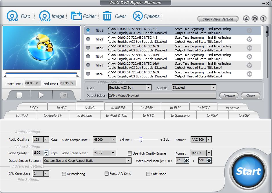

  1. I'm new to this forum and somewhat new to ripping DVDs, so any and all help is fully appreciated.
    I've ripped a full screen DVD (Head of State) using WinX DVD Ripper Platinum; see attached file for the configuration settings I used (defaults).
    When I play the original DVD via the DVD player, it displays in full screen on the TV as expected. When I run the ripped version from my PC, it displays in full screen as expected.
    However, when I stream the ripped DVD to my widescreen TV (Sony Bravia, 55 inch) via Windows Media Center, it does NOT display in full screen. Instead it displays from top to bottom in the middle of the screen with black spaces (~4 inches) on both sides.

  2. Banned
    Freedonia
    Title 1, presumably your movie based on the time codes in the picture, is in 4:3. Look where it says "NTSC 4:3". This is why your TV displays it like it does. It is showing it correctly. "Full screen" as you call it is NOT being displayed correctly for this film! So basically you have your DVD player set up to output everything it plays stretched to 16:9. As far as why it looks "full screen" on your PC, I would have to actually be present with you and see not only what you see but your set up. Either your software is just stretching it to 16:9 or you are actually seeing 4:3 on your PC but the image is so big that you do not realize it.

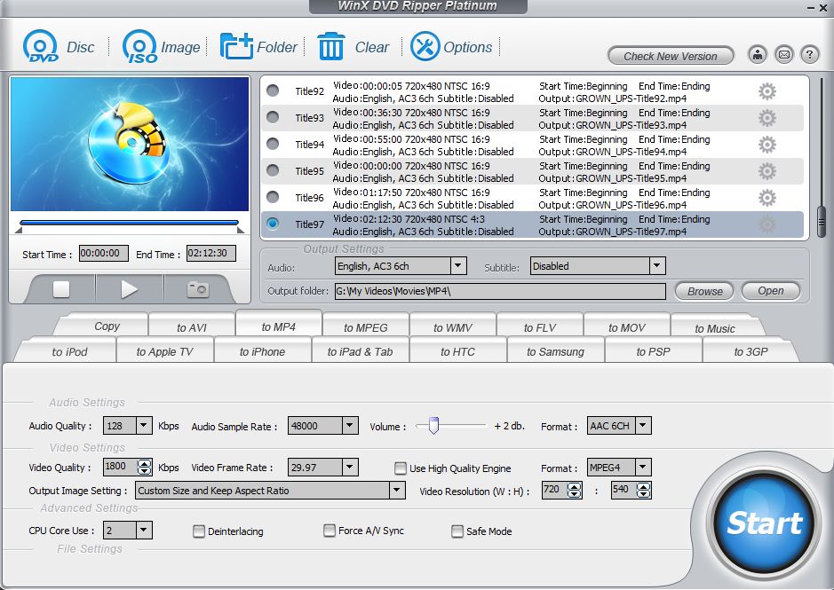

  3. jman98,
    Thank you for your response and education. I fully understand your explanation, but here's where I'm confused.
    I've ripped "Grown Ups" (see attached configuration settings) and as you can see it's set at NTSC 4:3, however, the strange this is that it's displaying on my Sony Widescreen TV in "Full Screen" with NO manual intervention on my end.

  4. opps forgot to upload the file...sorry
