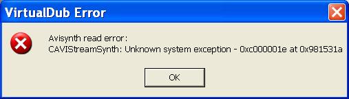

  13. For the first time AVS File imported succefully, but when I press play 0 in Virtualdub Or when I tried to save as AVI an Error is happened:
    (AviSynth read error:
    CAVIStreamSynth: Unknown system exception - 0Xc000001e at 0xab7531a)
    are you familier with this error?

  18. AVS is Imported to vdub but when I tried to use it an error appeared
    CAVIStreamSynth: Unknown system exception - 0Xc000001e at 0x981531a)
    and I tried another videos but result is same!
