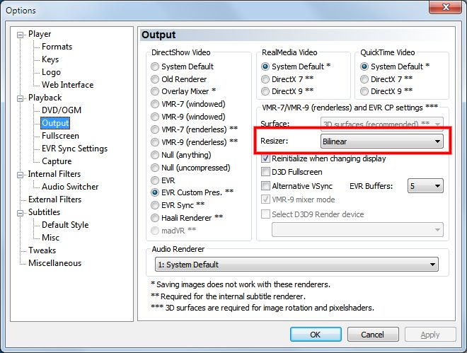

  8. Did you check the Resizer option ins MPCHC?
    [Attachment 10612 - Click to enlarge]
    I did tried to change it, but with no success. Anyway, uninstalling k-lite solved the problem. But now, I got another "small" problem. If I enable CUDA acceleration in CoreAVC, it is slower than disabling it. I did not had this problem with my old computer. It is not that important, now that I can play videos normally.
