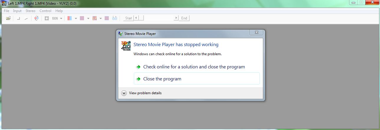

  5. Actually, i've just figured out how to get both files into StereoMoviePlayer, however everytime i do it it crashes in Windows 7 !!!!

  7. Member Cornucopia's Avatar
    Just saw your last post - SMP is NOT compatible with Windows 7.
  8. Hi Scott,
    AAAArgghh !. Oh that's a shame !.
    Thanks for the info.
