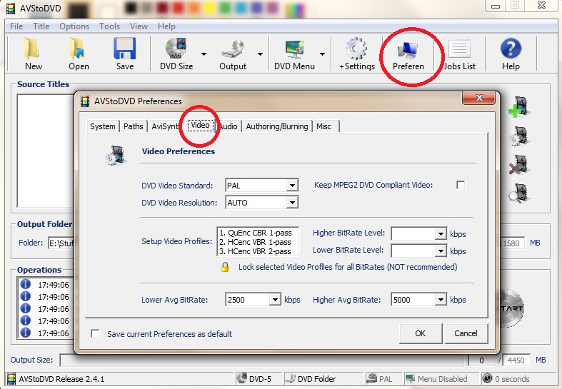

    The Video tab is in the Preferences section of AVStoDVD

  16. Found it thanks. Should I start a new "project" before I Open?
    Kept saying files not found so I had to click a "share" box before I could see them. OK?
    File types in the small group of files I wish to convert are AC3, D2V, Movie Clip, Quick Time Movie, and MP4 Video. Will all these be treated the same with this program? What file type should I see on the end product before I burn to DVD?
  17. Found it thanks. Should I start a new "project" before I Open?
    If you noticed there is a little check-box in the lower left corner in the above picture "Save current Preferences as default". If you check that after changing the video standard to NTSC all new project would be NTSC

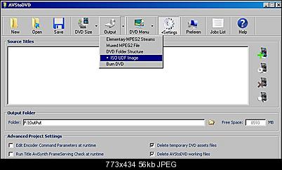

    And a small tip for you. Most authoring programme is able to create an ISO-file as it's output instead of burning a DVD. In ASVtoDVD in looks like:
    You may watch this ISO-file in VLC player so you'll know how your DVD will be like before burning. You may then burn the ISO-file to DVD using ImgBurn or the like
