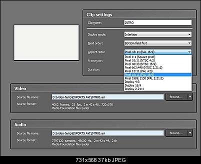

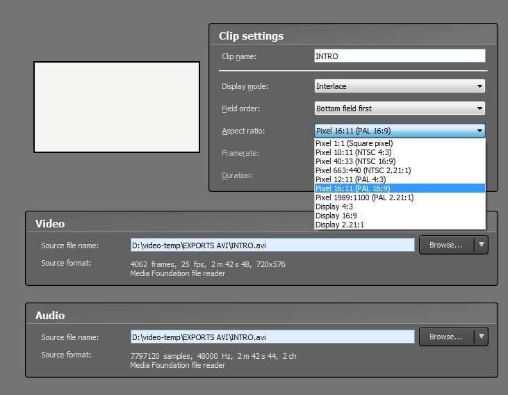

  3. Thanks Baldrick. I amnot entirley sure what kind of AVI it is so dont know if mpeg4 modifier will work. Will give it a go. As for your suggestion of making a new avi with those ratios, how would you go about that> TMPGEnc does not give me those options separately. Here is what is available:

  4. Are you making a DVD? Or a Divx/Xvid AVI? If DVD, leave the frame size at 720x576 set the source aspect ratio to Pixel 16:11 (PAL 16:9) and set the output AR to 16:9 Display.

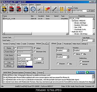

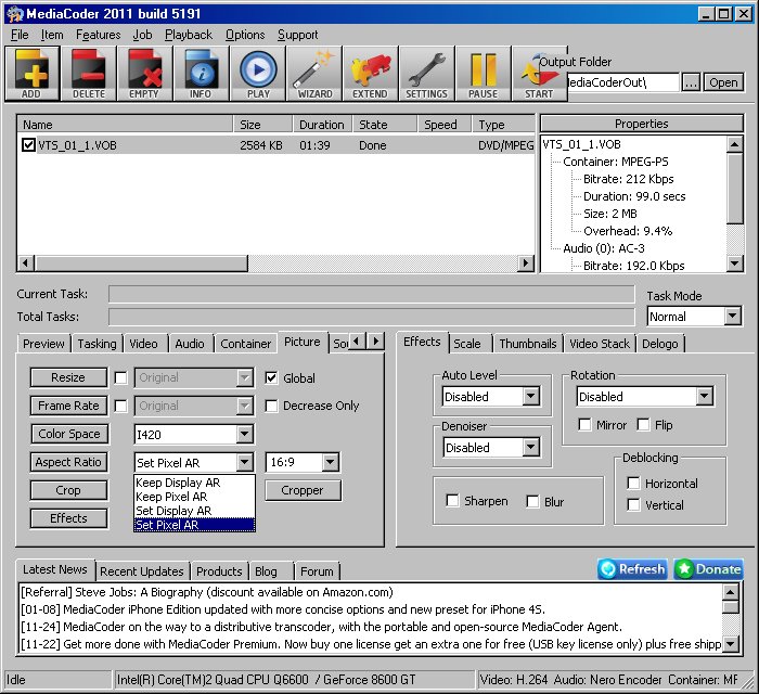

  5. MediaCoder is my friend

    But .. just wondering .. why don't you not just take the clips from the original MPEG ... and if an AVI container is your target ... transcode those clips .. avoiding one transcoding step .. and loss of quality

  8. Thanks for all your help and suggestions so far. I feel like a proper dunce now, because the fix was as simple as this:
    Start new 16x9 project
    Import clip into timeline
    Right click on clip and select properties
    There is then the option to change AR.
    Duh!!!
