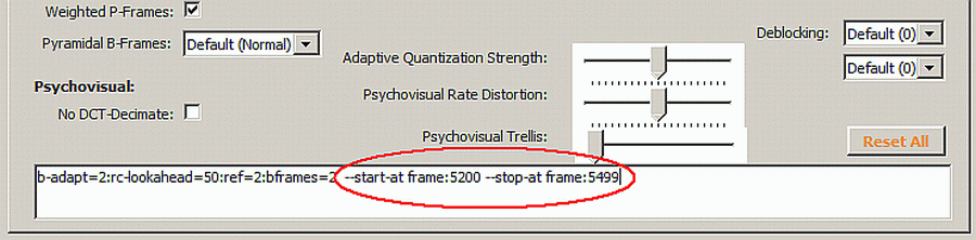

    Hint to do a short encode, in the advanced tab type the start and end frames.:

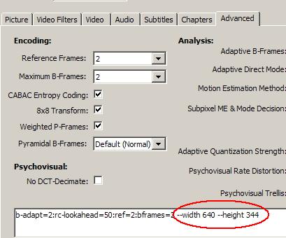

    Basically, if you want such a low bitrate then you'll have to reduce the resolution or the frame rate. Probably both.
    You could try an encode with the resolution set manually and a bitrate of 400:
    The best option is get a bigger disk drive.

    Added an attachment to my previous post before reading your reply.
    Please refresh the web page.

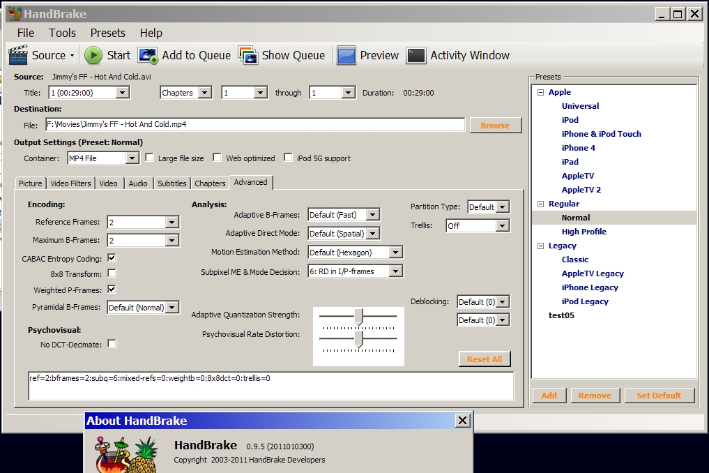

    This is my Advanced tab. Handbrake for Windows.
    From here. http://handbrake.fr/downloads.php
    Not sure why your's is different.
