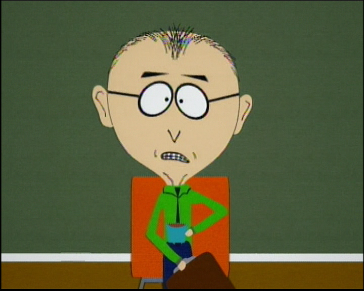

  1. I do not expect an optimal one because I don't see it being possible to eradicate selective chroma flickering without false positives, but this forum has proved me wrong many times when I had people who've done video restoring for a living insist otherwise.
    I tried Bifrost, LUTDerainbow, Derainbow and SSIQ from Vdub. Bifrost and LUTD did nothing. Derainbow is a more impressive filter that greatly reduced rainbowing but dulled many vibrant colors of false-positive objects. SSIQ's strength was damn noticeable too, even more noticeable on regions where it's unwanted.

    Like all derainbow/dotcrawl filters, you should use it before any other filters (so while it's still interlaced, before srestore, before everything else - it should be the 1st filter after the source filter)
    It's chubbyrain2, not chubbyrain ; some frames have residual artifacts so you can tweak the settings, stack something else , or use a mask with strong chroma filtering
Name:	42 original.png
Name:	42 chubbyrain2.png

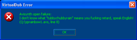

    My bad. I first typed "tubbychubbyrain" and was ready to bust a cap when avisynth said:
    I couldn't find any documentation for chubbyrain2. What are some things I can tweak? I noticed setting to -1 filters the strongest but even then it misses spots.

  8. The problem (especially with this source) is it has gone through too many conversions with analog, PAL, NTSC, and there is blending, so any autodetection mask will fail, either will miss areas, or overshoot areas . That's the same reason why the usual dotcrawl filters failed in your other thread, and damaging , heavy overkill filters were required to get rid of all the dotcrawl
    You can see the mask used by chubbyrain by using show=true, and tweak it using mask tools , it will be difficult to isolate ONLY the rainbows and nothing else on this source
    One way you can improve the results is use a heavy filtered version, with a lightly filtered version, with mt_merge , at least you can limit the damage that way

    I did, and I'm lost. Increasing both to 20 strengthened the filtering very slightly. Decreasing to 1 strengthened it noticeably, and -1 strengthened it even more. Going above 20 nullifies the filter completely. Actually, going above 10 nullifies it.
    Oh well, I've decided to use it selectively on scenes where rainbowing is particularly prevalent. I don't even know if it's that big of a deal TBH. My main concern is removing illegal entropy from the video, because we're aiming to match both DVD quality and the famous RM bitrates.
    Chubbyrain2 is the best out of all the derainbowers I've seen so Mr. Mackey will be pleased to see the end of his little rainbow infestation problem in his hair.

    @Sanlyn, the error message was a joke, chubbyrain2 worked fine.
  10. If you want an overkill script
    a=MPEG2Source()
    a
    chubbyrain2(show=true)
    msk=last
    a
    chubbyrain2(th=1, radius=15)
    base=last
    base
    fft3dfilter(sigma=16, plane=3, bt=4, interlaced=true)
    heavy=last
    mt_merge(base, heavy, msk, luma=true)
    You will notice it gets rid of almost all the rainbows, but also color edges start to get eroded. You view the mask and view how it overshoots many areas. You would have to modify the msk layer to get more accurate, there might be some novel ways, you can ask at doom9. Adjust the sigma value to adjust the "overkill" settings. You can try to sharpen the chroma at a later stage with mergechroma(awarpsharp2 (#somesettings))
    You have to ask yourself what is the lesser of evils ? Can you live with some rainbows or would you rather have fewer rainbows and blurry color edges
    What more concerns me is the destruction of the colored interlace combs which causes color-ghosting upon deinterlacing later. I'm impressed with the filter however. The removal of the rainbows is absolute and erosion of edges is minimal. I still cannot allow this globally but I won't mind doing it on scenes with severe rainbowing.
