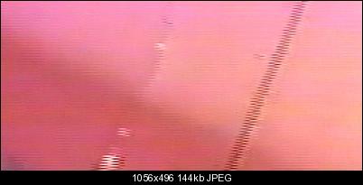

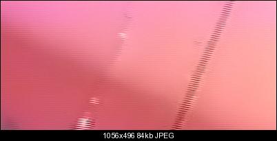

  1. Something's not right when using avisynth and neat video the result is different than on virtualdub, i have asked the question on neat's forum some time ago, no answer...
    Experiment: take the same video, same noise profiles, parameters and see what's coming out
    Pictures:
    Vdub:
    https://forum.videohelp.com/attachment.php?attachmentid=10562&stc=1&d=1326745102
    avisynth:
    https://forum.videohelp.com/attachment.php?attachmentid=10563&stc=1&d=1326745132
    The result with vdub is better (look at the chroma at the upper right side) so either neatvideo don't like avisynth or virtualdub is adding some kind of filtering (!!) .
    The 1 million $ question is more about how to reproduce this filtering in avisynth (assuming this theory is true)

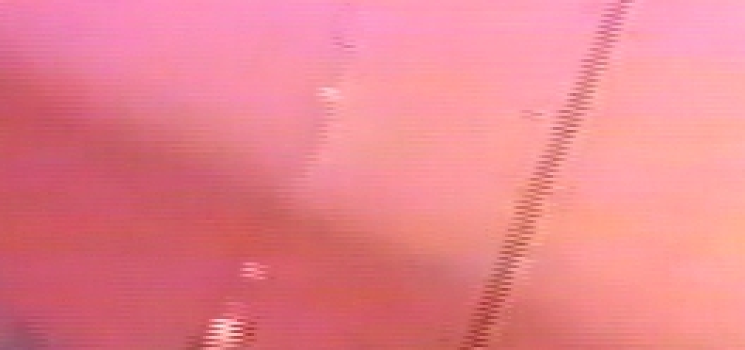

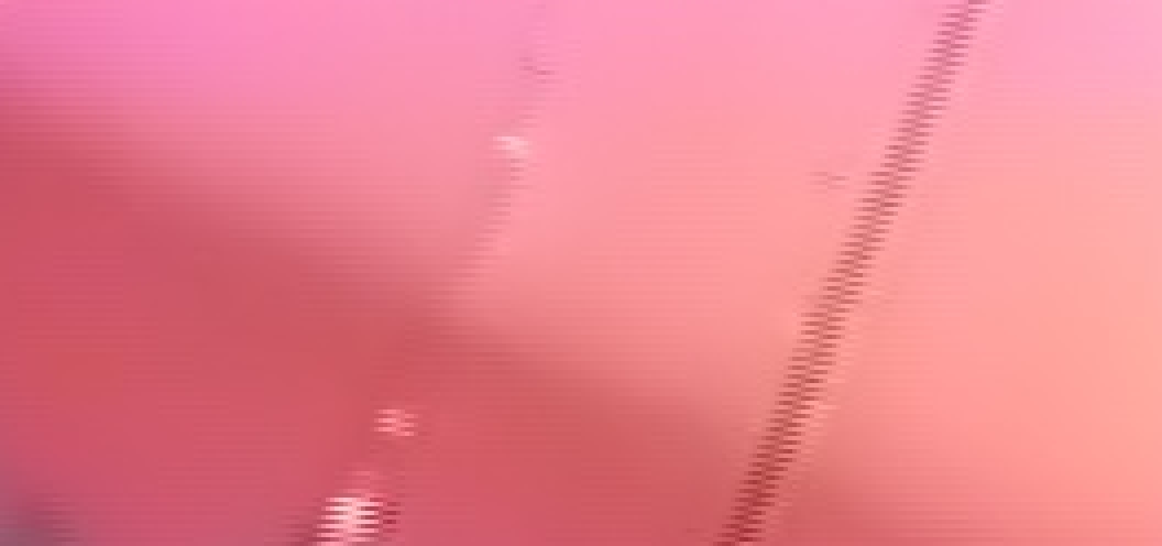

    Zoom-In (Vdub/avisynth)
ID:	10564Click image for larger version

    I'll probably leave this to the experts here, but I suspect you are getting a colorspace conversion through VD that Avisynth doesn't do. Try adding a brightness/contrast filter in VD before the NV filter and see if anything changes. (Not sure if you need to make any adjustments with the B/C filter, try it without any first.)

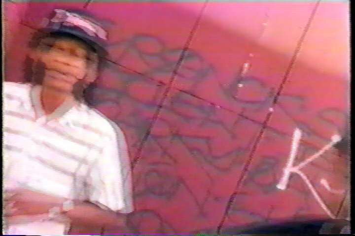

  24. It's a big mess in other words. I will focus on that later for now denoising, color correction only
    edit:
    Here's where i'm at:
    http://imageshack.us/f/28/whereimat.jpg/

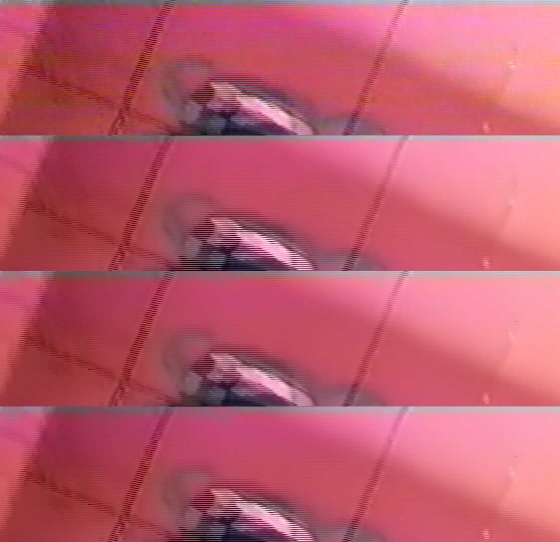

  25. Ok guys i found out what's wrong, take a look at this picture which compare the different results i have obtained:
    In the order: original, Neat Vdub, avisynth Neat (normal), avisynth Neat (my solution)
    https://forum.videohelp.com/attachment.php?attachmentid=10668&stc=1&d=1327575563
    I'll let you guess what i did, it wouldn't be fun otherwise
    Now the result is "on par" with Vdub

  27. No No, it's real avs scripting, no trick involved.You can do better sanlyn come on.
    A tip maybe ? Something's wrong with converttoyv12 (oops i said too much)
