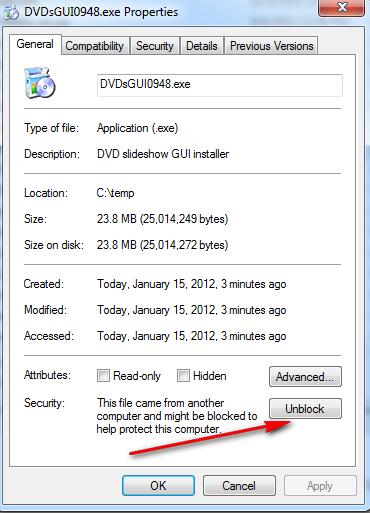

    are you sure you have the file downloaded and not just a link to it? the file should be 24,428KB. and on some computers you need to unblock the file.
  5. The file I have is the same size as yours. Thanks for the tip ... I had not checked the unblock box. I corrected that however I still get the same error message.
