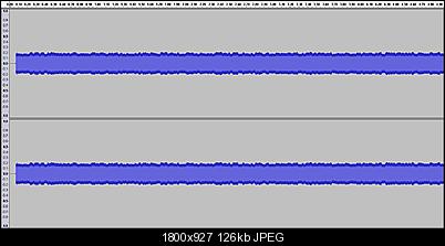

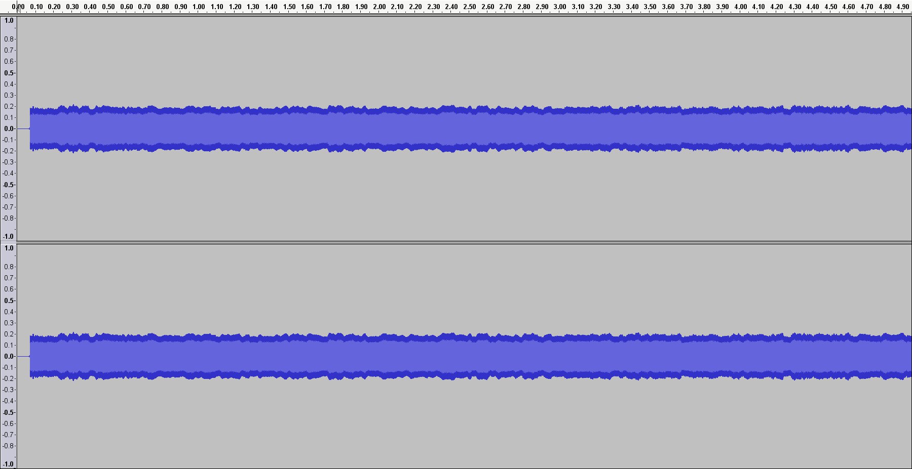

    This is what I'm seeing from audacity:
    I'm half wondering if YouTube is adding some sort of watermarking to the audio. I can't see any reason why 128kbps AAC audio should have such noticeable artefacts.
    I double checked the original file I uploaded to YT (128kbps mp3 audio) and that looks fine.
