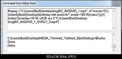

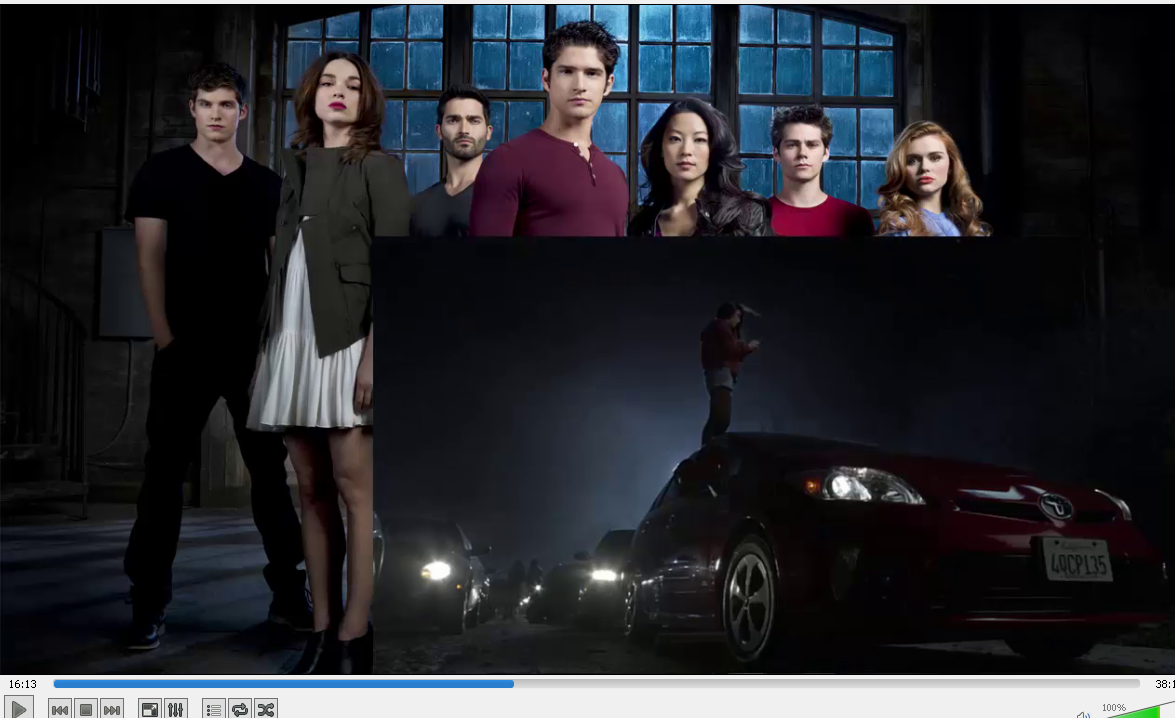

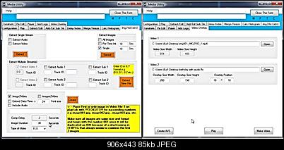

    Blackwindow, Your question is off the subject of this thread (ffmpeg-script-batch-file) but since it's here... With ffmpeg easiest way is make a video of the image as long as the length of your video. To make a 30 second video from your image:
    "C:\Users\Bud\Desktop\MEGA_Trimmed_Tabbed_2\bin\De bug\ffmpeg" -loop 1 -f image2 -i "C:\Users\Bud\Desktop\img001.jpg" -c:v libx264 -t 30 "C:\Users\Bud\Desktop\img001_IMG2VID_2.mp4"
    Now overlay it with the video insertion:
    ffmpeg -i "C:\Users\Bud\Desktop\img001_IMG2VID_1.mp4" -vf "movie='C\:\\Users\\Bud\\Desktop\\birthday with audio.flv'",scale=100:75[video1];[in][video1]overlay=10:10 -crf 20 -q:v 2 "C:\Users\Bud\Desktop\img001_IMG2VID_1_OVRLY_3.mp4 "
    NO TRAILING SPACE AFTER MP4
    That will put the video in the top left corner and sized to 200x150. To move /adjust change the Scale=w:h parameter and the overlay=X:Y
    You will get:

    Took 2 minutes:

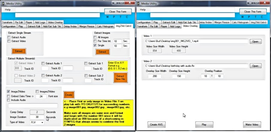

    Blackwindow11, The first string takes a JPG (img001.jpg) and turns it into a 30 second MP4 (img001_IMG2VID_2.mp4).
    The second string uses the MP4 (JPG image 30 seconds long) and overlays it with the movie (birthday with audio.flv), scaled to 200X150 and placed at overlay position 0:0 and creates the final MP4(img001_IMG2VID_1_OVRLY_2.mp4)

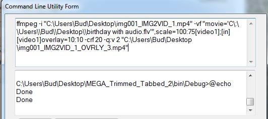

  15. Member Budman1's Avatar
    Jul 2012
    NORTHWEST ILLINOIS, USA
    Don't ask me how to get it to stop truncating my code but the correct code should be [video1]; between the 100:75 and the [in] and no trailing space after final MP4.
