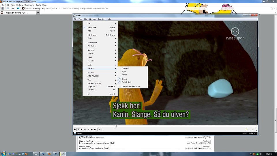

  12. I'm a Super Moderator johns0's Avatar
    canada
    The subs are dvb imbedded.
