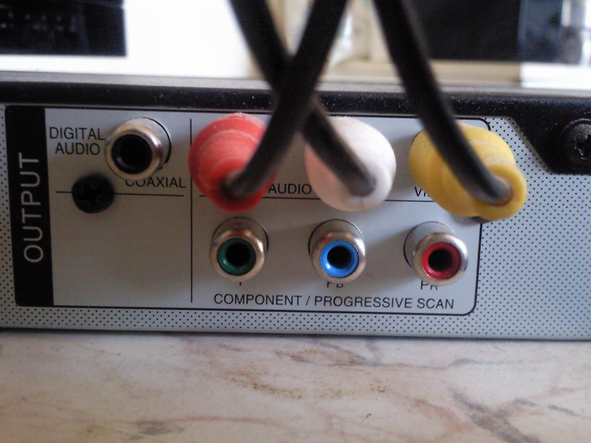

    This is my dvd player (below pic) and below link is a system that I am being offered by a friend;-

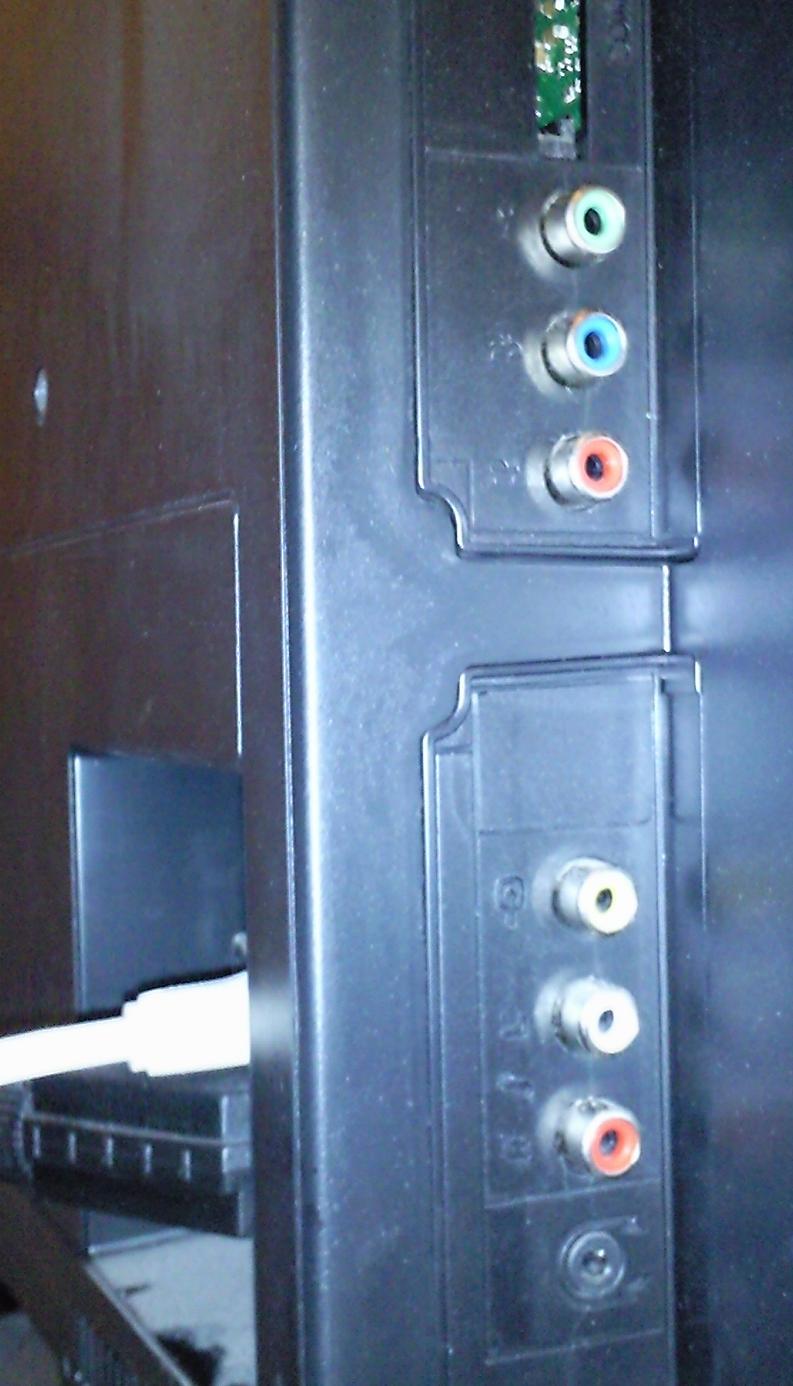

    Hmmm, I bought and connected the red, blue & green cable to my dvd (above) and corresponding TV connections, but have tried every method of tuning it in, but nothing.
    On one setting I got visual but no audio, and the visual wasn't even better quality than the red/white & yellow cable?

    The TV should have separate audio red/white connections grouped with the analog component Green/Red/Blue video connections. You should be seeing better quality using the Green/Red/Blue video connections.

    Show us your TV connector panel and identify the TV model number.

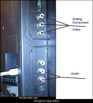

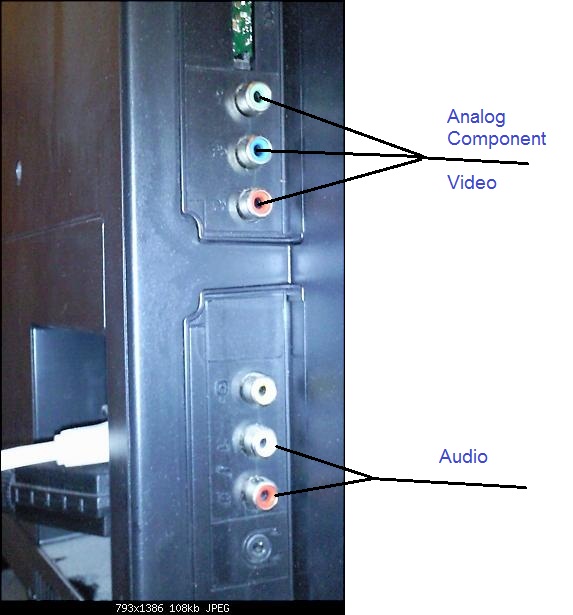

  17. Originally Posted by aelfheah View Post
    You have to move the red/white audio cables to the same input as the component cables.
  18. Member
    Nov 2006
    I tried the rca cable in my dvd and into the red/white/yellow on the TV (JVC-32DG20J), but couldn't get a channel? I must be missing something?
  19. Member edDV's Avatar
    Mar 2004
    Northern California, USA
    I can't find the manual for that TV. There must be a menu setting to select audio source.

  20. Originally Posted by aelfheah View Post

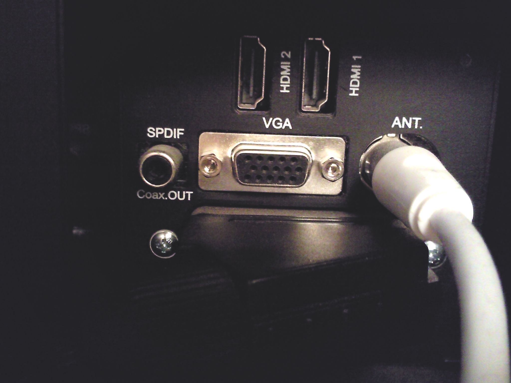

    Is that all your inputs? There must be more.

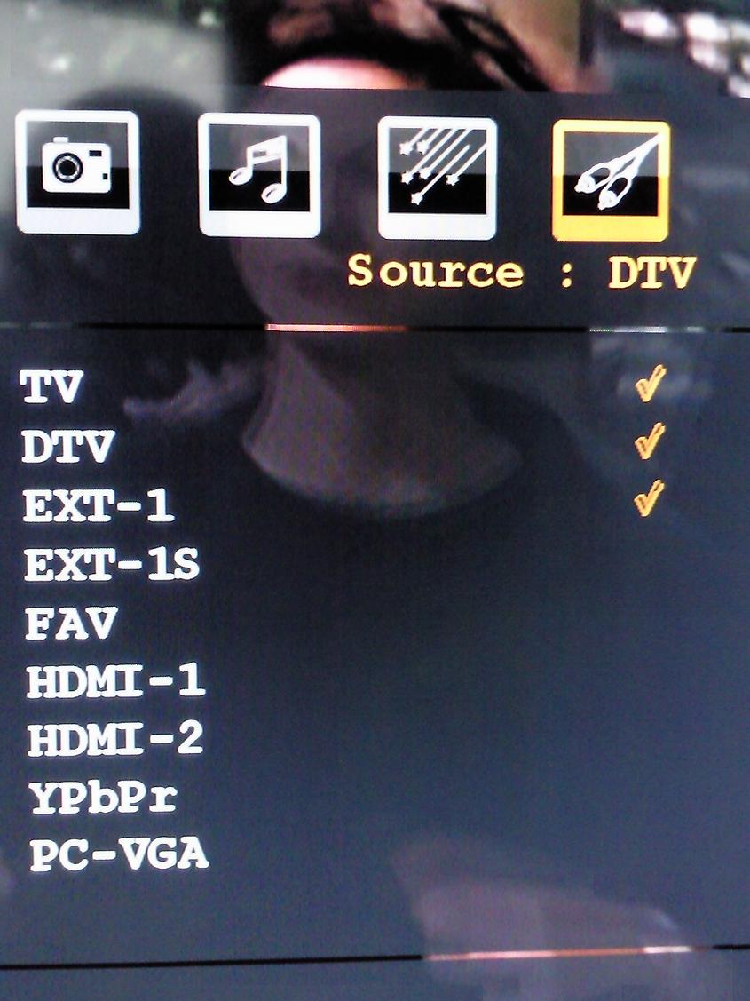

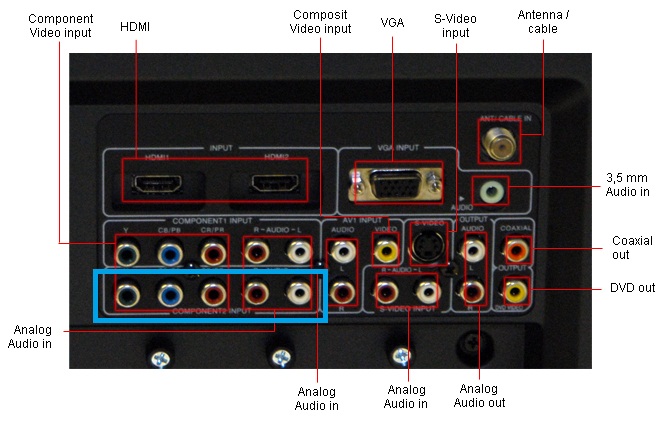

    Nov 2006
    These are the TV's other rear connections and the actual TV tuning menu (I did try tuning with the others below). Should I be using both cables- the RCA for better visuals and the red/white/yellow cable for the audio?
    Sorry, electrics aren't my best topic.

  22. Originally Posted by aelfheah View Post
    You should be using the component cable (red/green/blue) for the video and the red/white cables for the audio. You don't need the yellow cable. Although, if you leave the yellow cable plugged in, you may be able to quickly switch back and forth between component (YPbPr) and composite (EXT1?) to compare the two.
    It would be even better to get a good upscaling player and use an HDMI cable. In this day and age I'd get a Blu-ray player. Then you have the option of viewing Blu-ray discs. You bought a nice HDTV, wouldn't you like to see some real HD material on occasion?
  23. Member
    Nov 2006
    Thanks jagabo, that worked, yay! Yes it's better quality.
    I did have a bluray player but it wouldn't play any of my vast collection of divx movies (which are 6x smaller than a bluray film and easier to 'acquire'), so I decided to stay with this dvd player for now.
