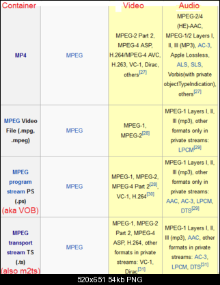

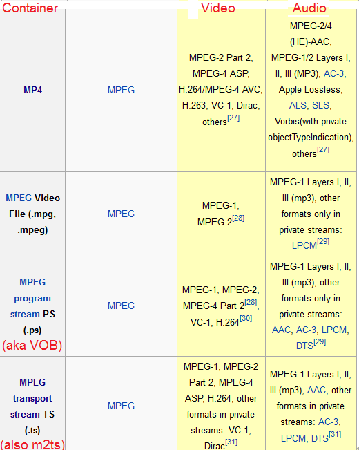

    You need to separate the notions of video codec and container format.
    MTS is an MPeg2 packetized transport stream (aka m2ts) container. This is the same container used for Blu-Ray and AVCHD camcorders. It is a random access version of the M2T (or TS) MPeg2 transport stream container used for digital broadcasting and also for the HDV camcorder format.
    MP4 is an MPEG4 container which was extended from a Quicktime base.
    Either can contain MPeg2 or h.264(MPEG-4 Part 10 aka AVC) video stream content plus audio, subtitle and metadata streams.
    So when you say you want to convert MTS to MP4 without re-encoding, you are saying you want to change containers only.
    Ref
    http://en.wikipedia.org/wiki/Comparison_of_container_formats
