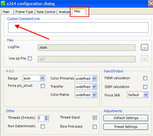

    There is a command line box (I think it' s on the last tab, I'm going by memory here) when you modify the the encoding configuration. You might have to checkmark the advanced settings box . If you cant' find it, I'll have a look

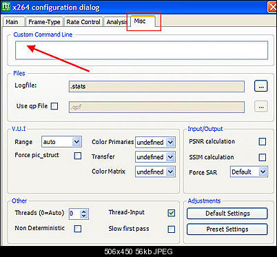

    Apprenlty you are unable to set the SAR in Megui according to this http://en.wikibooks.org/wiki/MeGUI/Aspect_Ratio_Signalling_in_AviSynth_Scripts but then i have seen other people talking about it. I tried adding it to the scrip section but it did not work.
  7. Click image for larger version
    Add it in the encoder settings, not the script . Hold on, I'll have a look and post a screenshot

    I owe you a beer, you were 100% right. I ran an encode with out anamorphic encoding, resizing or cropping and it came out perfectly. I am rather confused now about everything as it was hard enough to originally get my head around anamorphic encoding. If i was to remove the 8+8 black bars with cropping would that mean i would need to use a different SAR and Anamorphic encoding ?. Can you suggest any recommend reading on this subject but its rather interesting but daunting at first. If there was a thank you button on here you would be getting many thankyous. !
