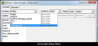

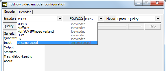

    Yes, that seems to be the problem. Only a handful are left:

  8. The newest version of FFDshow I could find with the full set of VFW encoders was rev.3631 dated Nov 15 2010.
    [Attachment 10470 - Click to enlarge]

  11. Originally Posted by mh2360 View Post
    Thanks for the info! I couldn't figure out what I was doing wrong, trying to find conflicts etc. to explain why all the other encoders didn't show up!
    Do you know WHY they've been removed in later versions? I don't see the point of the pack without the encoders, for my purposes anyway.
    http://forum.doom9.org/showthread.php?p=1467129#post1467129
    We are trying to remove all inferior and non-working stuff. For two main reasons: (1) because they are not maintained and thus we can't do any bugfixes, and (2) to direct users to better alternatives. I absolutely don't mind keeping MJPEG if there are good reasons to keep it. But such arguments should come from people who still use it now and not from people who used it a few times long ago. So far I have seen one good argument, it having good performance for capturing. It having good quality has already been debunked, as other format perform significantly better in that area. Of course the performance argument could use some validation as well.
