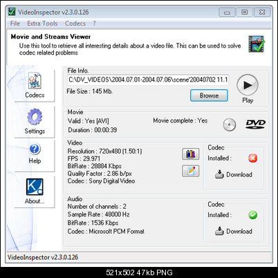

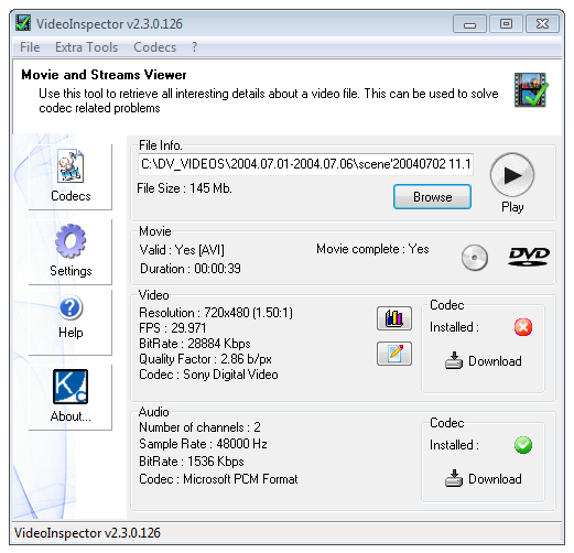

    I have individual clips for each scene all filename timestamped. Here's what VideoInspector has to say about the format
