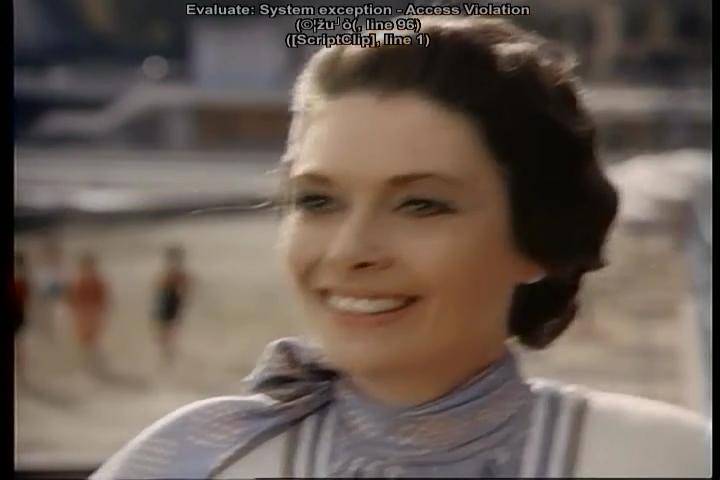

  25. Actually, there were a few different errors:
    Evaluate System exception - Access Violation
    (????, line 109)
    ([ScriptClip], line 1)
    (????, line 96)
    Evaluate System exception - Guard Page Violation
    (????, line 110)
    (BReC@ReC, line 110)
    LoadPlugin: unable to load "r \Program Files (x86)\AviSynth 2.5\plugins\GRunT.dll"
    (????, line 109)
    I don't know what "lfr" means
    (,line 96)
    ([ScriptClip], line1)
    ???? is some random assortment of characters, usually six, often <' ' or >'z':
    The errors only seem to occur when the number of threads exceeds the number of cores (I'm running on a quad core, non hyperthreaded i5 2500K). And the higher the number of threads the more often they occur.
    And the behavior is different with different programs. VirtualDub might hang or crash on opening the script. x264 runs to completion with the error messages embedded into the frames.
    Well crap, it looks like I'm running version 2.57, not 2.5.8. Odd, I reinstalled AviSynth just a few days ago.
    I'll uninstall and reinstall and see if there's any improvement.

    Wow, that's a bizarre set of errors - looks like there is some random memory corruption going on.
    2.57 MT is known to have some multithreading errors that were fixed in later MT versions, so it's worth trying another, but it seems the most reliable way to avoid problems is to run SRestore single-threaded (using mode 5 or 3).
  27. Well this sucks. Given that I was using the outdated version of AviSynthMT I updated to 2.5.8 and then 2.6 MT build. The latter is more stable but there's a big drop in performance.
    Using the 2.6 MT build I got about 2.7 fps running the earlier script with no SetMTMode(), about the same as I was getting with the regular 2.6 build and the 2.57 build. Running the full script with only SetMtMode(2,0) at the start increases the speed to about 3.7 fps and the resulting video looks ok. Using only SetMtMode(2,8) drops the speed down to about 2.0 fps but the video was still fine. With AviSynth 2.57 that increased the encoding speed to about 7.5 fps but resulted in the error messages mentioned earlier. Using the full "safe" script with multiple SetMtMode() commands (in post 21) drops the encoding speed to a mere 0.9 fps! Version 2.57 ran that script at about 7.5 fps and generated no errors. I may go back to 2.57!
    Am I doing something wrong?
