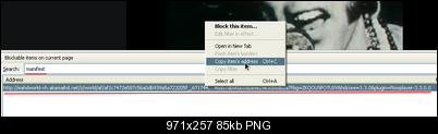

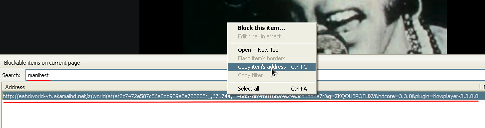

    hi
    tools: firefox; adblockplus addon; livestreamer
    livestreamer "hds://http://eahdworld-vh.akamaihd.net/z/world/af/af2c7472e587c56a0db939a5a723205f_,671744,344064,.mp4.csmil/manifest.f4m?hdnea=st=1437607360~exp=1437650560~acl=/z/world/af/af2c7472e587c56a0db939a5a723205f_,671744,344064*~hmac=d55a741b9614fb6916a992f428961896824bdc94b4a91d7ec0ee797ccfaabfad&g=SDEHOLGCCWEZ&hdcore=3.3.0&plugin=flowplayer-3.3.0.0 pvswf=http://player.yle.fi/assets/flowplayer-1.4.0.5/flowplayer/flowplayer.commercial-3.2.16-encrypted.swf" best -o popstory3.flv
    with in red the url manifest find with adblockplus

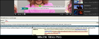

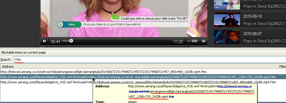

    first find hds link (.f4m) tools: firefox; adblockplus addon

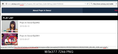

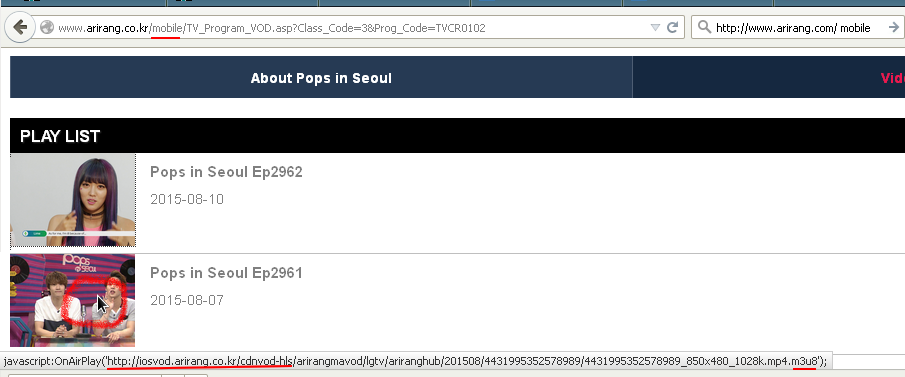

    second i go to site but the mobile's version
    http://www.arirang.co.kr/mobile/index.asp
    and i look how is the link
    so
    livestreamer "hls://http://iosvod.arirang.co.kr/cdnvod-hls/arirangmavod/lgtv/ariranghub/201508/7215179980721457/7215179980721457_1280x720_2428k.mp4.m3u8" best -o Pops-in-Seoul-Ep2962C3-HELLOVENUS-interview.ts
